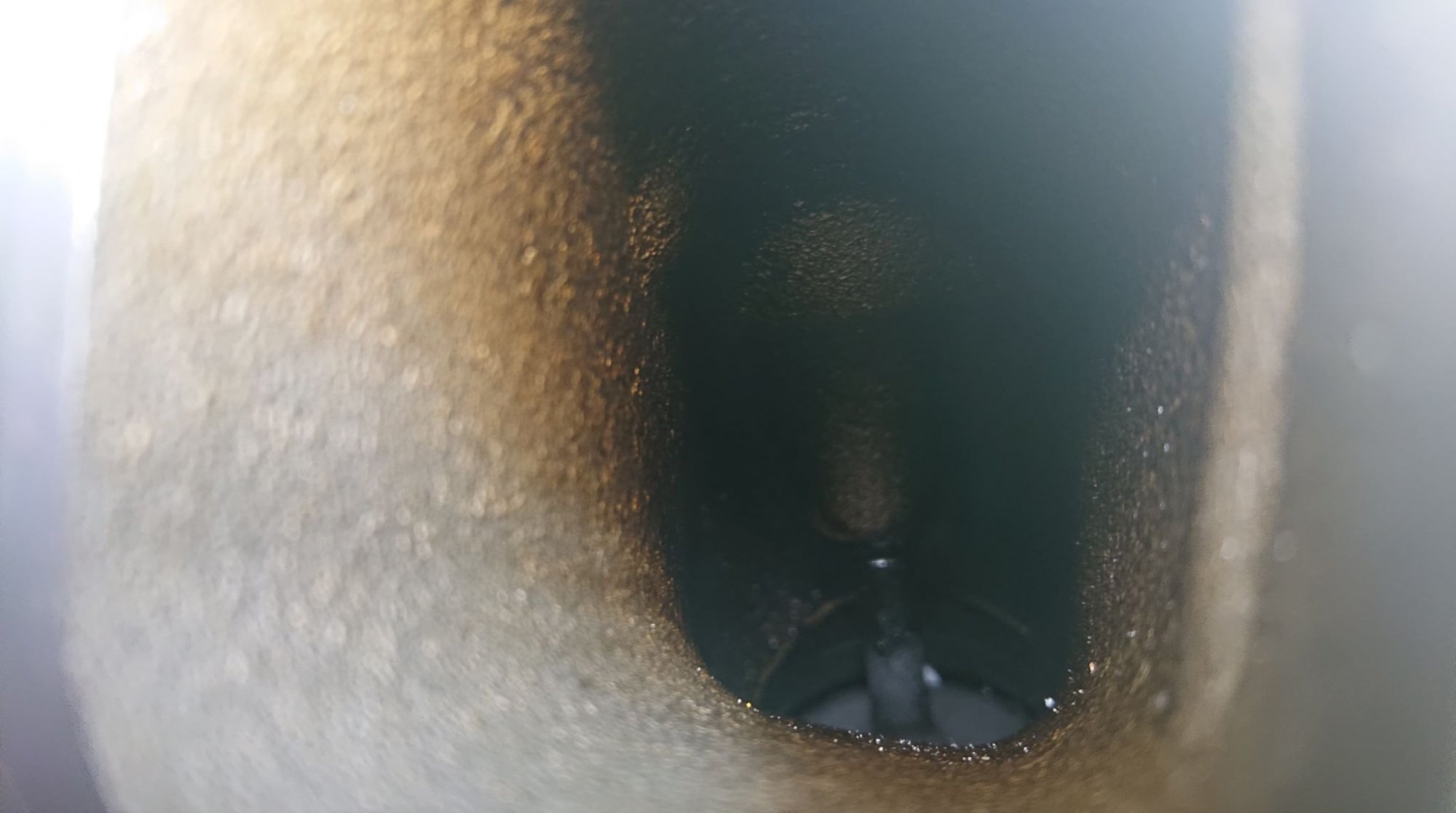

Oh, and not even 5,000 mles on my truck yet and my valves already look like shit.  I've changed the oil 3 times.
These trucks are direct injected, they don't get the benefit of the atomized fuel cleaning the valves as it enters the cylinders. A good pcv catch can is almost a necessity.

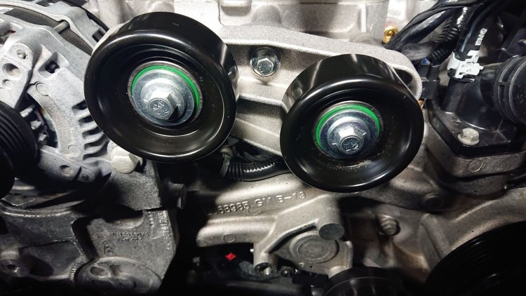

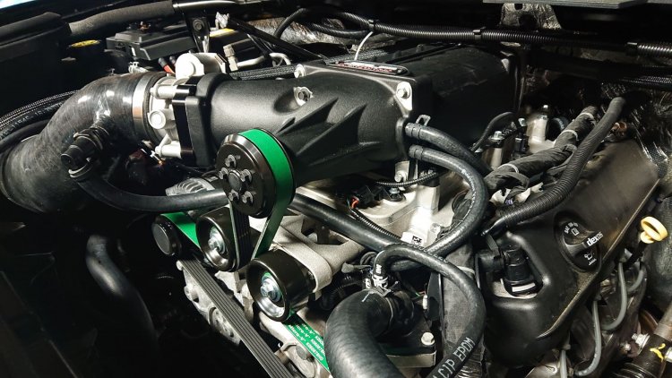

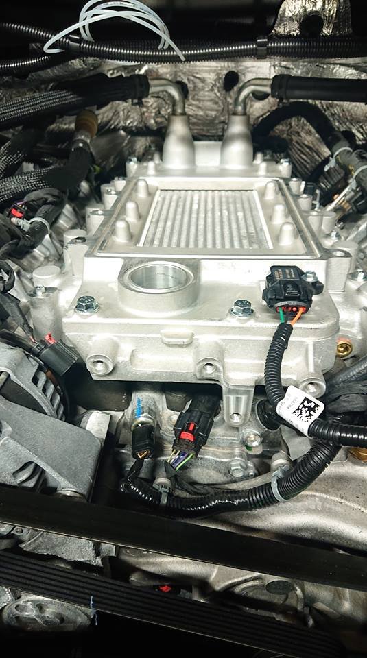

So my new manifold showed up today, (in a Roush Racing box :sick:) so I got the installed finished.  Pretty straight forward, here's a bunch of pictures.
Intake
Boost gauge fitting
Blower. The seal is and o ring that fits in a grove on the manifold. It was a pain in the ass to seat:
Pullies
And done. I added the Gates HD belt, it came with a regular Gates belt.
supercharger6.thumb.jpg.3d6d3dad615a38ec264483ba5f63ecfe.jpgsupercharger5.thumb.jpg.136a21dbd4e81e1c7d2777ed09b1e7a5.jpg
The SLP intake it came with. I'd rather use the stock airbox, but I'll have to rig something up later for that.

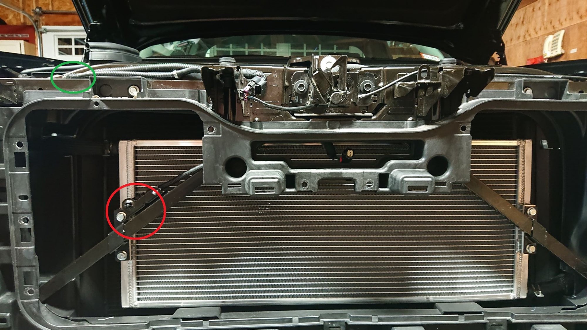

So today I replaced my spark plugs with NGK 5107 plugs. These are the plugs that come in the Whipple supercharger kit and were recommended by my tuner. He said to gap them to 0.022"-0.024".
He also said to remove the active grille shutter and he would delete the codes for it. So I did that today. The ambient air temp sensor for the radio temp is on the bottom of the shutter, but the mounting hole for the '14-'16 trucks is still on the' 17+ trucks, so I modified the harness and installed the sensor in the older Truck location.
Here's some pics in case anyone wants to delete these too.
The red circle is the new location of the sensor, and the green circle is the connector for the harness. I forgot to take a before pic so I stole a pic from @BlackBear88 since that was the first one I found in a search. LOL
Original temp sensor location.  You can actually see the new location to move it to in this pic also.

2 hours ago, Nasty said:
What is active grill shutters?
2017 and newer trucks and suvs have that shutter on the front. It closes at high speeds to reduce drag. I think it also closes when it's cold to help heat up the coolant faster too.
Deleting it will make sure I'm always getting air flow to the heat exchanger.
