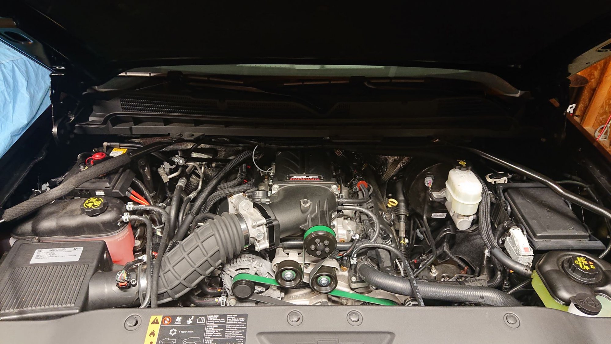

Full Engine compartment shot:
  • Like 3
2017 and newer trucks and suvs have that shutter on the front. It closes at high speeds to reduce drag. I think it also closes when it's cold to help heat up the coolant faster too.
Deleting it will make sure I'm always getting air flow to the heat exchanger.
How do you delete it?
Sent from above

I pulled it out and my tuner will shut off the codes for it.  It just bolts in.

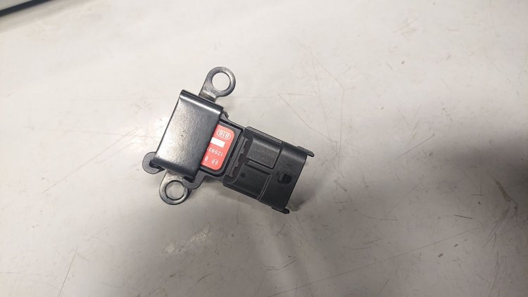

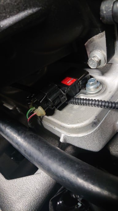

I changed out my MAP sensor to the LT4 sensor, which is what my tuner uses on his builds and recommended.
I had to modify it to bolt into the manifold, but it uses the stock plug, so I eliminated the jumper that came with the supercharger kit.  SLP uses a Bosch Ford spec MAP sensor.  I was getting an immediate P00C7 code with the old sensor. It cleared right away with the LT4 sensor.
I ended up using a bracket from a Duramax ambient pressure sensor and trimmed the stock bolt hole off.  Afer I did that, I was able to bolt it into the SLP manifold.
