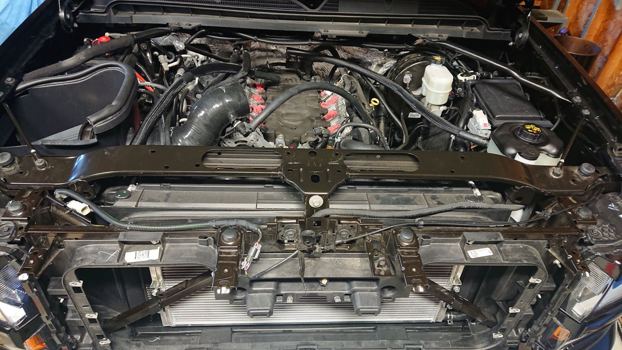

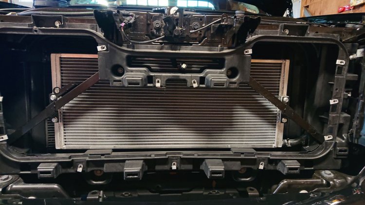

So  I woke up this morning with the intention of installing my supercharger. I get the heat exchanger in first since that's the hardest part.  I was able to remove the radiator bolts and push it towards the engine and slide hte HE in between the core support and condenser, instead of tearing the whole nose off like SLP wants you to.
heatexchanger1.thumb.jpg.e5b8383a27c1cc1b03fcef73224d9558.jpgheatexchanger2.thumb.jpg.9d1e9b912a3bf0b3167dcb41c1f6b980.jpg
Next was remove the intake and install the lower intake, here's where I had my issue.  The lower intake was cracked around the seal for the #7 runner.  That will never seal up properly so I'm going to have to exchange it.  Day ruined.  I did get everything else installed though, so when my new intake manifold comes in, I'll just have to bolt it on with the blower and hook up the cooling lines and stuff.

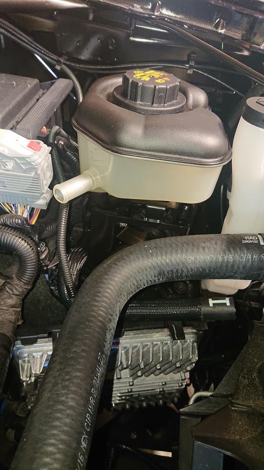

Here's some more pics

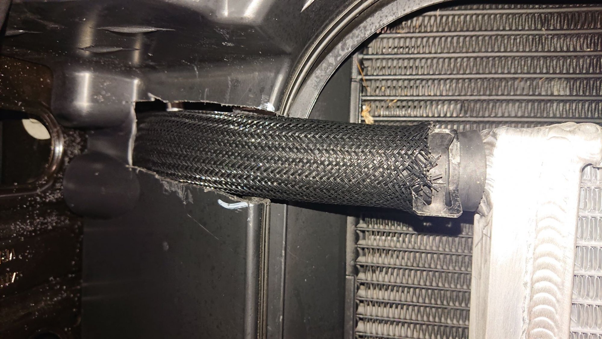

you have to cut some clearance holes for the Heat exchanger hoses.

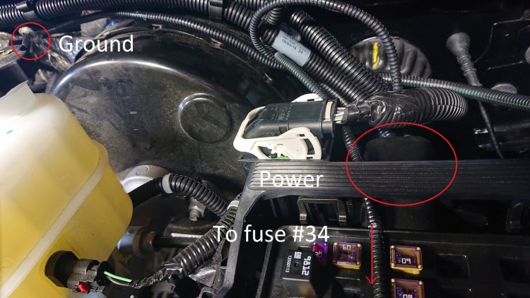

Here's the simple wiring for the heat exchanger pump.  There's a relay that bolts onto the Coolant bottle bracket.
