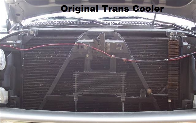

I installed a Long 40k LPD cooler I got off Amazon.com, made some simple brackets out of aluminum bar stock, mounted the cooler on the passenger side of the radiator, and used the adapter nipple to tie into the existing cooler with a hose.
I'm basically running the OE cooler and the Long in tandem. At 30 degrees ambient, I barely get to 100 degrees on the cooler. Towing my camper (5400#s) on a 65 degree day, I barely get to 165 degrees even on hard pulls.
Whoops, I guess it's a 28k...Long Tru-Cool LPD Transmission Oil Cooler 4590 28,000 GVW.

Here is my OLD Vs New
Thanks Sdeeter and Formula! I'm going to install that over christmas break. I put another 100 miles on yesterday in 30f weather and i'm having to baby the throttle way too much to keep it below 200f. I'll be adding more cooling capacity for sure.
