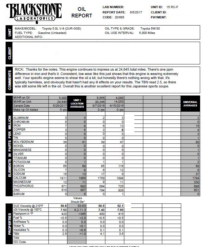

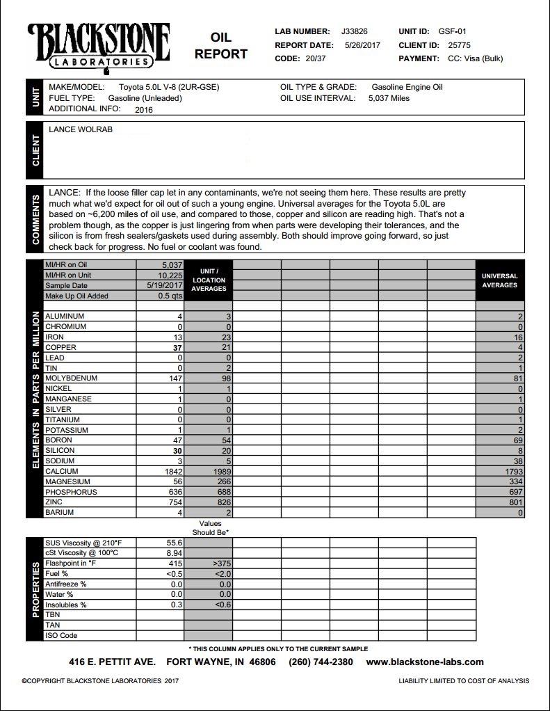

Thanks, I said, "Garage" but my computer skills are apparently as versed as Blackstones UOA's I have noticed like you said, nothing ever measures over .5% for fuel dilution? This really was my whole point of doing this test and to see if 15K oil is really still good at 10k+ in Phoenix heat? This will probably turn into another rabbit hole for me too it seems.......Thanks for the info this is good stuff! Mook!
post-173608-0-87734000-1497396710_thumb.jpgLance GSF.pdf
Here are two reports, notice the differences in fuel % and water %. Welcome questions of other values. This guy had a serious issue that he didn't realize until after the report. The difference was I was able to identify it. Blackstone just dismissed it out right and said no biggie. If it had gone uncorrected over time, would have wiped out the engine.

This is a typical report from them and why they really shouldn't be in the business. They stain like most labs, what UOA really can and will do. Anyone care to guess what's wrong with this report?
Unfortunately Tribologik's Expert System is not made for automotive applications, so don't bother reading it's "logic"
