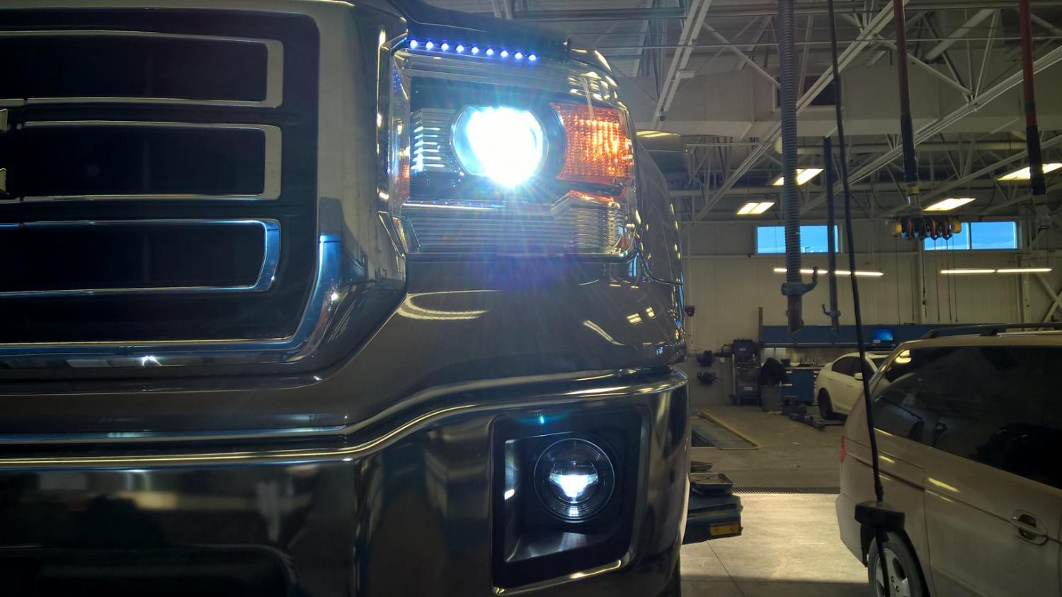

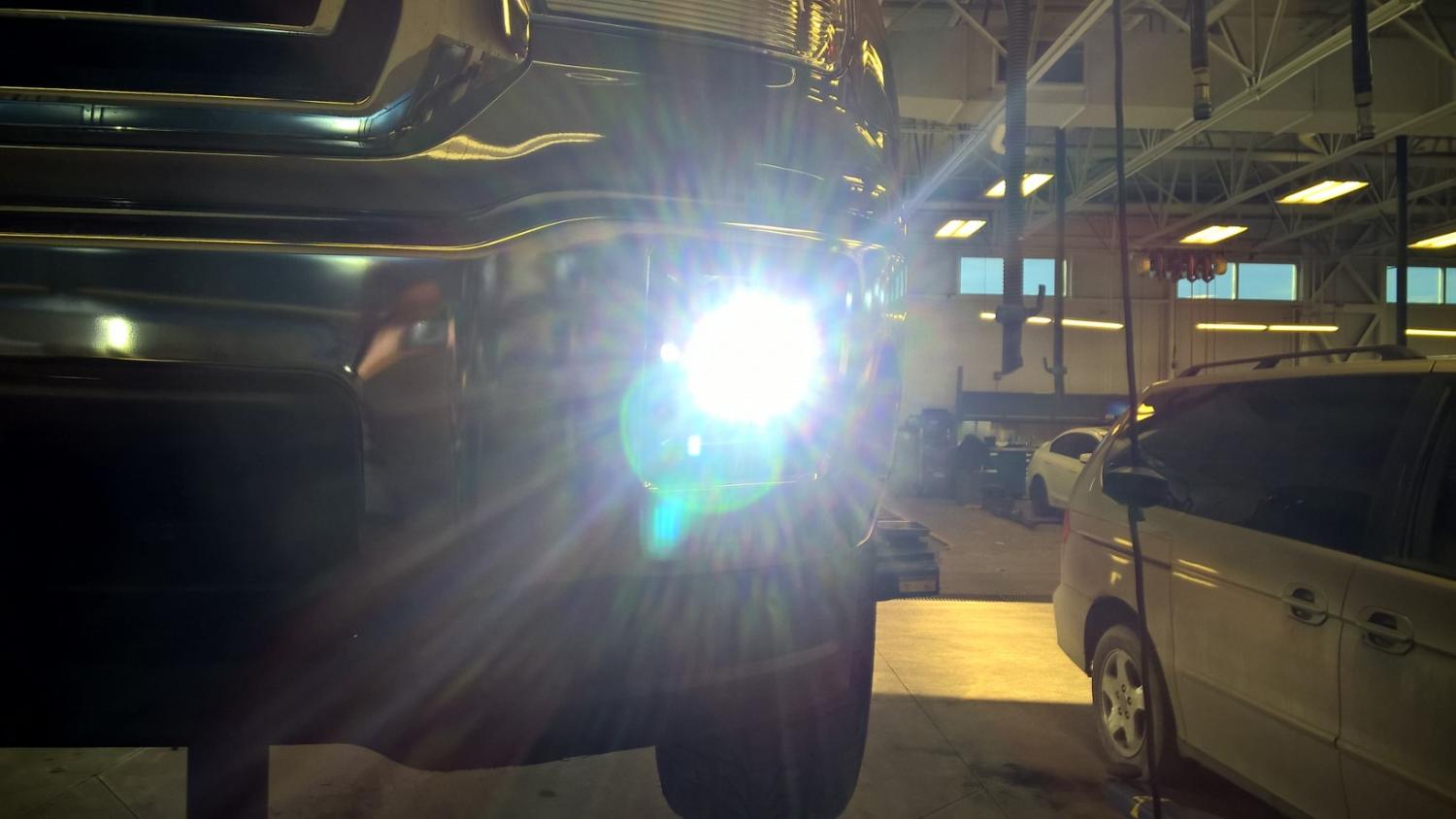

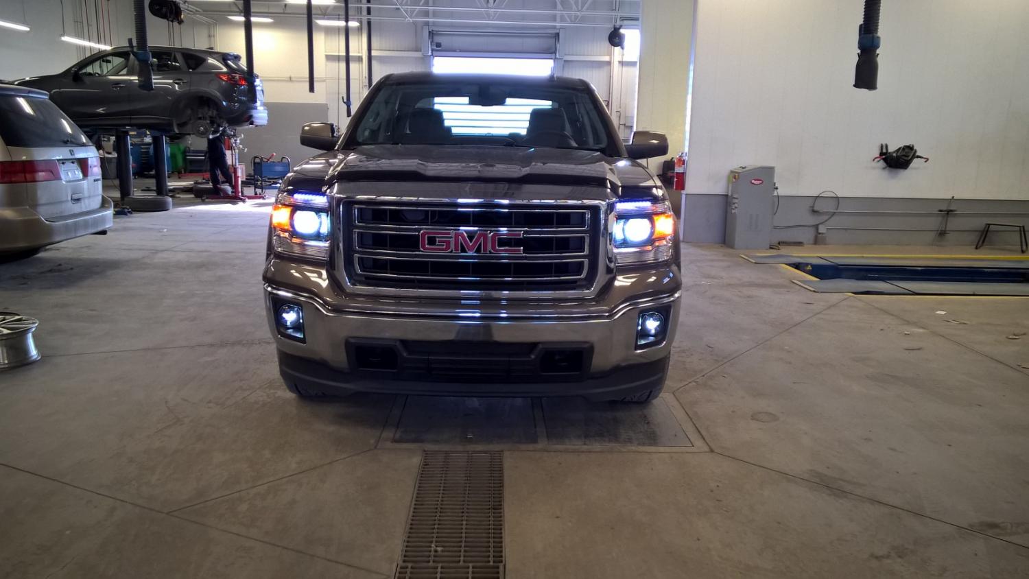

Received my fog lights earlier and already installed them. Took me a little under 50 minutes including watching Fondupot's installation video again. Someone on Youtube commented about using a 10mm socket on clips and that made things easy.
Will go out once dark to adjust height if needed.
