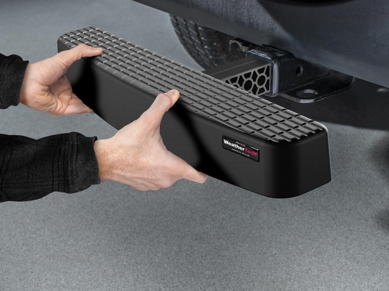

Check out Weathertech's new XL.
Oh, i didn't realize the weathertech steps are made with a honeycomb shaft to absorb minor impact. thats not a bad idea.

If you hit this thing too hard it will just break, avoiding any frame damage.
I'm not really a fan of how they look, but it seems like a nice way to avoid minor dings in the bumper. I could have prevented the few dents i had in my old truck from backing into retaining walls at low speed anyway.
That's not a bad solution at all. I would trust that over a hitch or similarly stiff step.

The weathertech XL so far looks like the best option
