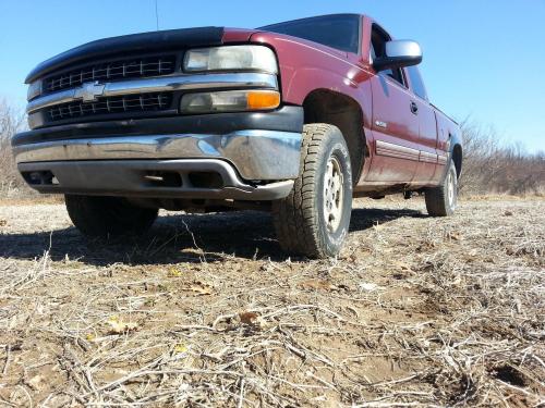

Just got the truck. It came up on craigslist for $900. I got there within an hour of his posting it and got the title. It has 256,000 miles but runs awesome, and the 4x4 works great. It's LT, leather, 3 door extended cab, 5.3 engine. I thought I didn't like Chevy's before, but just from driving this thing home, I'd have to say my rams are no better! I think this truck just won me over!
Anyway, drove her home and threw it up on my buddy's lift. Except for a lot of rust, the truck is in great mechanical condition. The only things it needs are a rear differential cover, and both front wheel bearings are REALLY bad. Can't believe I drove it home, Lol.
