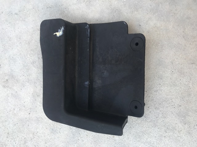

where does this part go?
I was looking at my engine today and noticed this piece was laying on the left side of the battery hoping somebody could help my truck is a 2016 Silverado with a 5.3l motor thanks again
Almost looks like a plastic insulator for the bottom of the battery tray to reduce NVH?
never thought of that will have to check tomorrow se if something is missing under battery maybe thanks
I looked but might have to remove battery to check under it will check tomorrow
Lol. I found one of those and couldn't figure it out. Last weekend changing my oil I found another. I believe they go up in the cowl area behind the hinges.

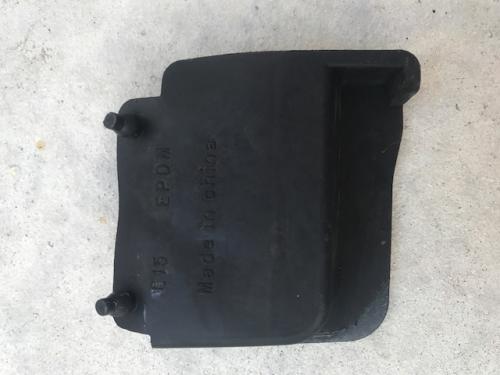

Its a debris/drip plug that fits on the ends of the front windshield cowling under the fenders.

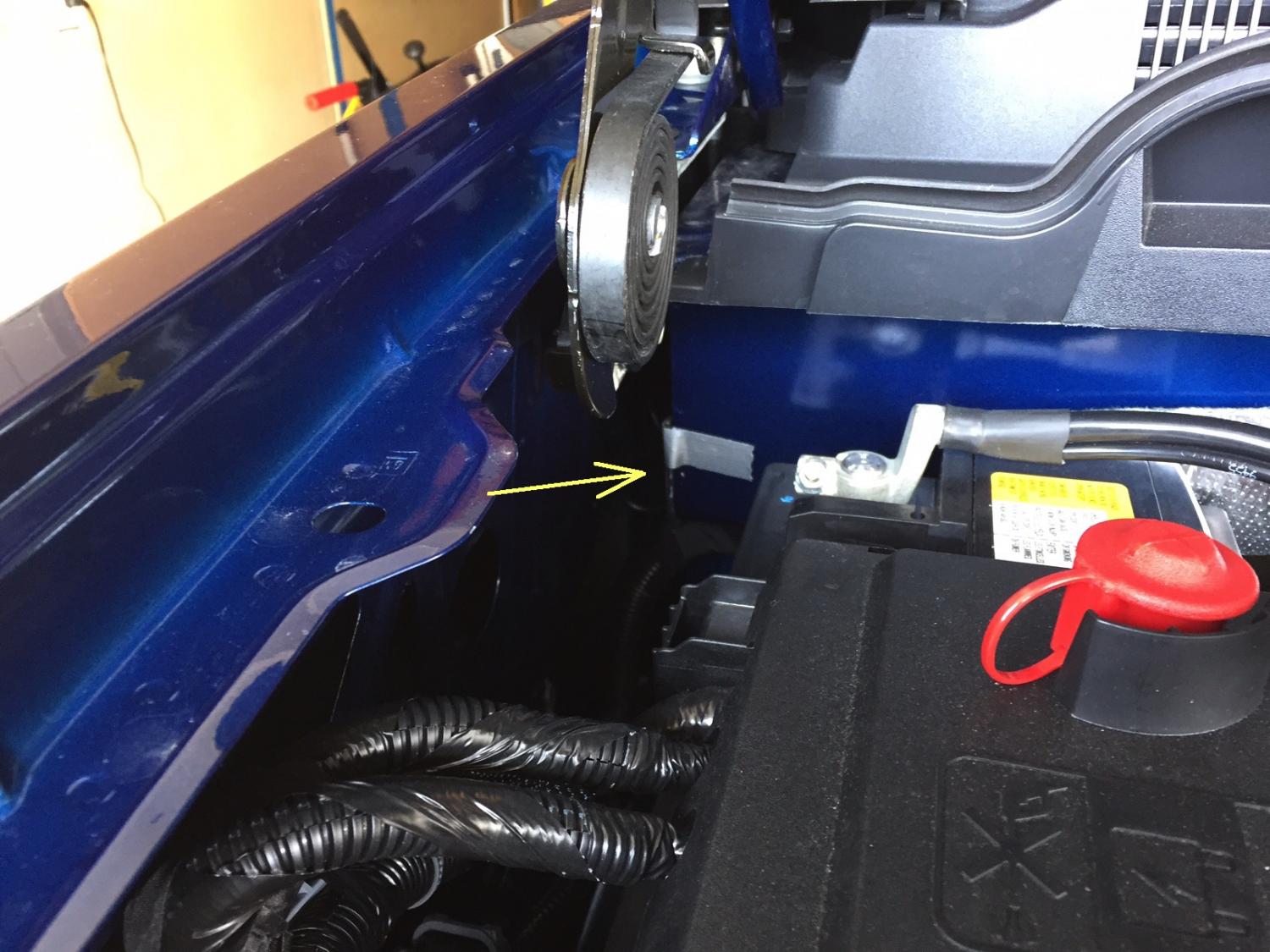

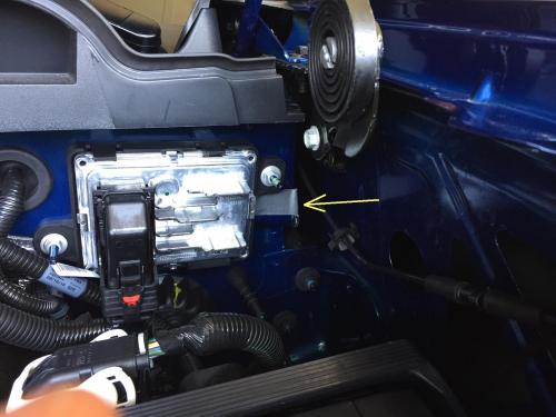

Ive got a few strips of silver tape over them to help keep them closed off to little critters but still allows them to drain.
