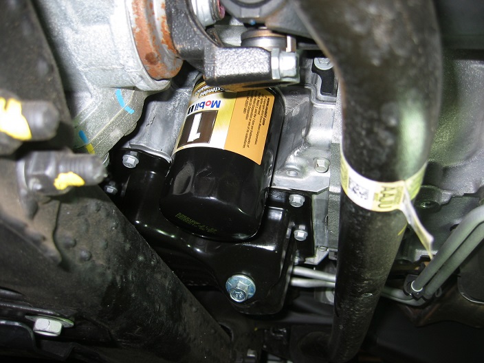

Quick Question - if I change the oil filter only - will the oil drain out.. or is there a "stop" valve of some sort to prevent too much oil draining ?
Auto-Zone has their Mobile 1 oil change kits on sale, 5qts + filter. Bought 2 kits giving me the required 8qrts plus 2qrts to spare. And the extra filter for an early filter only change out.
Spun off the oil filter at 1,000 miles and spun on a Mobile 1 M1-212 in it's place. Lost less than half a qrt of oil - you do have to work fast - a small but steady stream of oil keeps draining from the engine.
