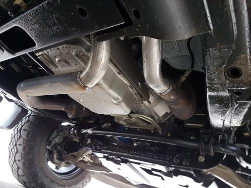

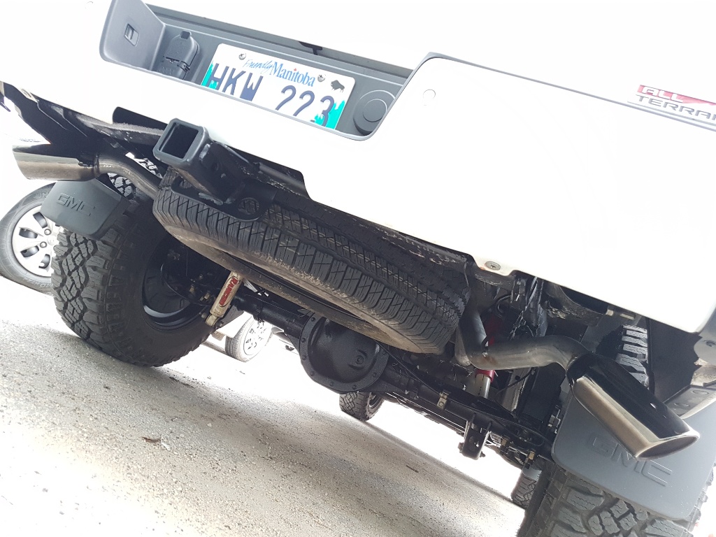

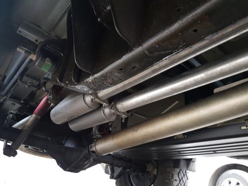

I had a custom kit done by a local shop that does a lot of custom work. I wanted a true dual and they advised against an X-pipe but I'm thinking about having one spliced in. One cat removed, Flowmaster Super 40s/44s (can't remember which). Little bit of reduced power off the line but at higher RPM it performs and sounds great. Smoked stainless tips.
