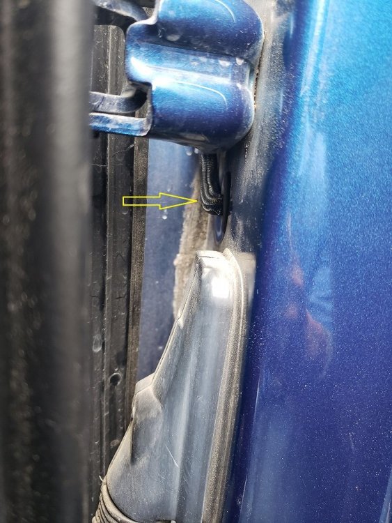

On 5/13/2017 at 10:15 PM, O_J_Simpson said:
Don't. Used the dedicated plug by the door hinge GM put there just for this purpose instead.
More details/pic please? I looked everywhere when I did the light bar on my burb, ended up going through the large bundle by the column. I'll be adding lights to my truck before too long.
Post a picture of your upper door hinge and we will circle it for you on your own truck.

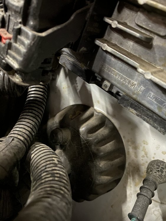

Needing some help. I tried this and apparently went too far to the middle and way too deep. Long story short, it's costing me a lot of time and money for a mechanic that didn't know what end was up. It burnt up some wires in there and now I have all kinds of sensor lights going off. My question is actually a simple one. Do I need to replace the entire engine harness with transmission wires or is there an easier (and cheaper) set of wires that I can replace? I've already tried to solder them and it's just not going to work. Thanks so much for the help!
On 5/13/2017 at 3:56 PM, Bushleaguechew said:
There's a big rubber grommet next to the steering column. Cut the nipple protrusion and fish your snake thru. It will come out above the parking brake
Is this the one your talking about?
