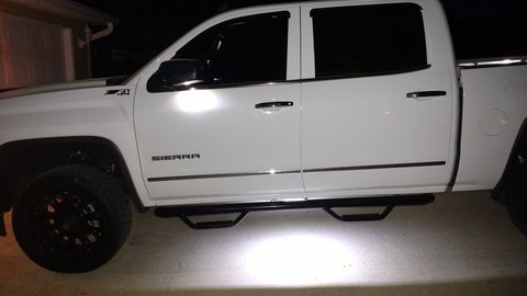

I installed step lights on my 2015 GMC sierra 1500. There is a grommet for the parking brake under the drivers side the I used the run the wire into the cab. I soldered the power wires together as well as the ground wires so I only had to get one wire in the the cab and to ground.

Don't have a picture but the grommet for the parking brake is easy to spot. Yes I ran the wires from the passenger side under the truck to the drivers side. I routed then trough the cross member. I did this because I only wanted one penetration into the cab.

I posted a picture on this thread so you can see where the grommet is. It is the same thing on the passenger side, except it's a solid plastic piece you will have to drill into.
I sealed with Marine Grade Silicone and haven't had a problem. And yes, just tap into the dome lights/or existing footwell lighting.
