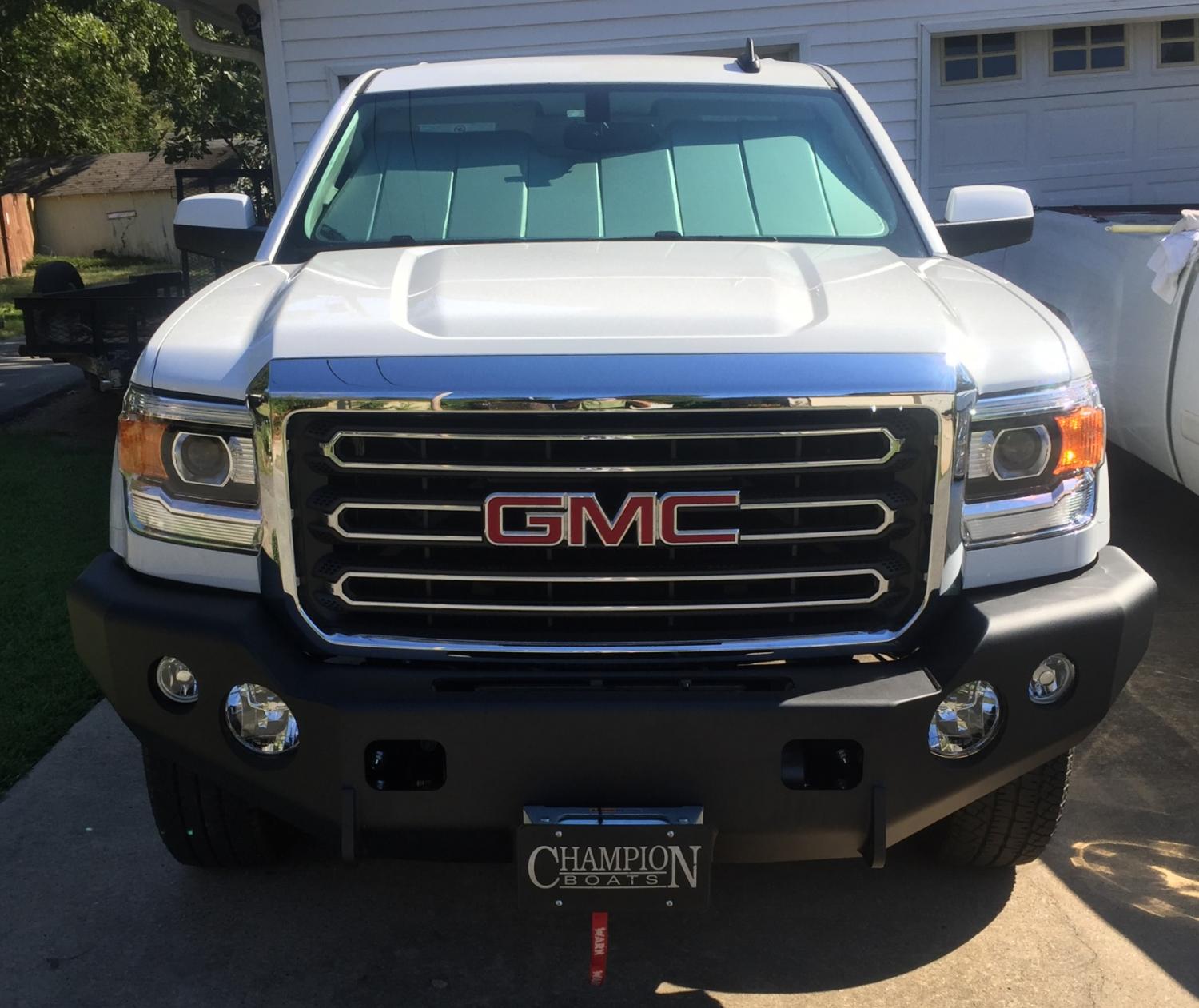

Dale, I am further south in Little Rock a bit warmer than your destination and I tow every week all around here. Have not seen any change in my transmission temp since my bumper install about year ago. Have a safe trip north ark is a nice area.
