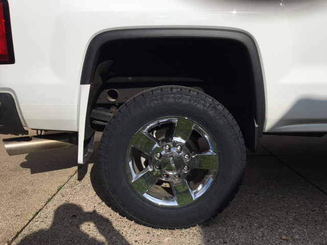

These are 35x12.5's with just cranked bars, no rubbing.
IMG_20170420_103722604_HDR_edit_14943556
x2, 35's on factory 18's, cranked factory keys 54cf854303a63947901df9770ae7c514.jpg
What tires are those SMiller? Toyo R/T?

Those 35's are actual 35x12.5x18's.

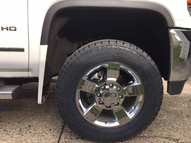

This is leveled with keys and shock extenders. The tires are 285.65.20, basically the same as a 295. You can see the clearance is very good and I never rub.nothing was done to the rear, front is not cranked up to the max. It drives just like stock.
Do you get much bump steer, or did you before aligning?
