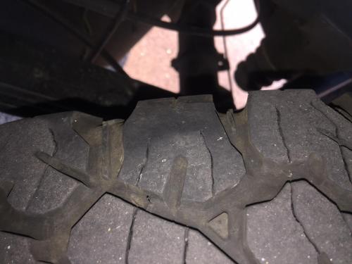

My truck is a 2015 Silverado 1500 Crew Cab with the max trailering package, 49k miles and has BFG AT KO2's (E rated tires).
I bought this truck a few months ago with 44k on it. When i test drove the truck, i thought the tires were a little loud but didn't think much of it. Sales guy said it was the tires as well so i didn't push it any further. Fast forward a couple months and the wife (who rarely ever goes in the truck) borrowed it while i took her Jeep in for an oil change. She came home and said, man you truck is LOUD.
Here's where i should note that i have over 80% hearing loss and wear hearing aids. So i told her it was the tires and she said i should replace them. But...the tires are pretty new with only 9/32-10/32 left on them.
The last couple weeks it seemed like the sound was getting louder and i noticed things felt more like a vibration as the keys would rattle. I downloaded a decibel app on my phone to see where things were at. At a standstill idle, i was getting 50-55 decibel. From 5mph on up, i'm at 87-91 decibels (which i know is loud because at work OSHA requires hearing protection at 85 decibels). The sound is hard to describe, but at low speeds when you are just rolling it almost sounds like you have tractor tires on or big mudder tires and as you go faster it goes into more of constant hum.

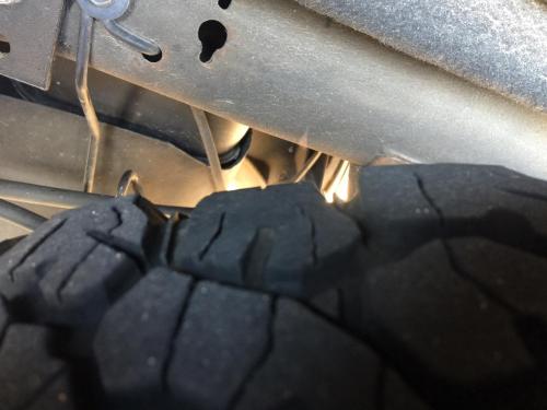

So last week i went to Discount Tire. They took a look at the tires and said, BAM, you have pretty significant cupping on the inside row of lugs on all 4 tires. Every other lug is worn down while the next lug is normal (see photos). Not wanting to spend the cash on tires that still had tons of tread left, they cross rotated them for me in a last ditch effort to save them. Well it didn't get any better so back i went to buy some new tires. Picked out a new set of Michellin LTX's , dropped the $1100 bucks and they slapped them on.
I anxiously jumped in for a peaceful ride home.....NOPE, not happening. The second the truck started rolling i could tell the sound was still there. A lap around the block and sure thing, the sound was exactly the same. So back i went and they graciously took the new rubbers off, put the old back on and didn't charge me a dime (super nice guys!).
Now knowing it wasn't the tires i started running through ideas in my head. It feels like it's coming from the front end more than the rear. The tranny has been shifting fine and the tranny temp hasn't been above 198-200 after a 20-30min drive (i think the cooling fan kicks in at 200). I tried shifting things in and out of the 2wd, 4 hi, 4 low and everything shifts fine. I've noticed now that the truck goes silent when making sharp to sweeping right turns, but is still loud on the left turns. I jacked up the front end and nothing feels loose and when i spin the tires by hand i didn't feel or hear the sound.
