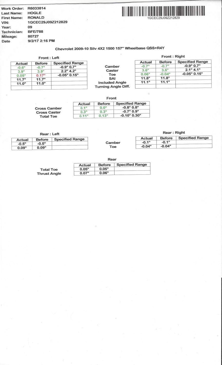

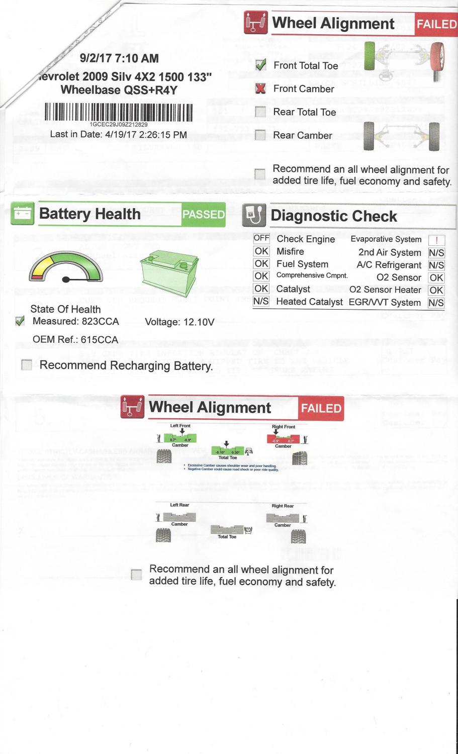

On the first page given to me by the dealer it shows my right front wheel is not aligned correctly (Red), and the left wheel is aligned correctly (Green). That was at 7:10 am.
Now I knew when I had it aligned a few years ago the right front camber was put out of spec by 0.1 degree and that is why it is showing that was red. I read the report and that is what it showed, and I wasn't going to complain about it or pay another shop for another alignment to fix 1 degree.
The second page shows before they aligned it at 2:16 pm and if I am reading it right, the left wheel was out of alignment, and the right wheel was ok!
Why is this backwards? Is it possible I am reading this wrong?
So what do you think?
