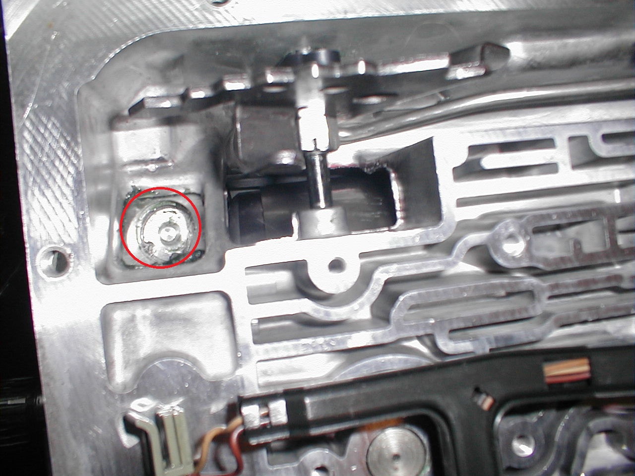

Soft / delayed shifting, is caused by poor line pressure rise due to a leaking boost valve, clogged EPC filter screen, failing EPC solenoid, or worst case: leaky seals throughout. Seal restorer may fix last problem, but probably remove and rebuild needed.
Here's some pictures on locations and what stuff is:
post-175614-0-59653500-1505840018.jpgpost-175614-0-26173200-1505840017_thumb.jpgpost-175614-0-17353000-1505840018.jpgpost-175614-0-93678100-1505840013_thumb.jpgpost-175614-0-73226100-1505840014.jpgpost-175614-0-07783600-1505840015.jpg
Hope this helps what's going on???
