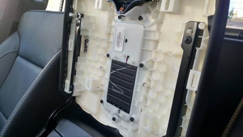

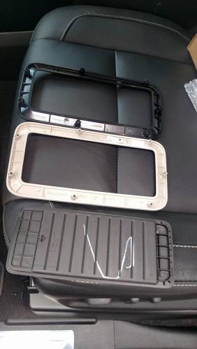

Installation was easy. First, with a panel removal tool, pry plastic cover off the underside of the console lid. It is on there tight, so be patient, and pry slowly. Once removed, the cell phone charger must be removed. 4 T20 Torx screws holds it to the console lid. Once the charger is out of the way, the tray/bezel is attached to the lid with 7 more T20 Torx screws. Simply remove them, and the tray comes off with the rubber mat. Simply swap the parts, and assemble in the reverse order. Make sure the charger power cable is properly tucked into the lid hinge arm prior to snapping the plastic trim part back on the lid.

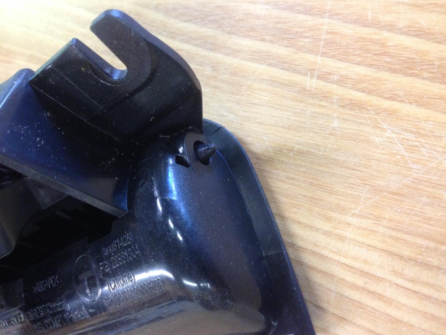

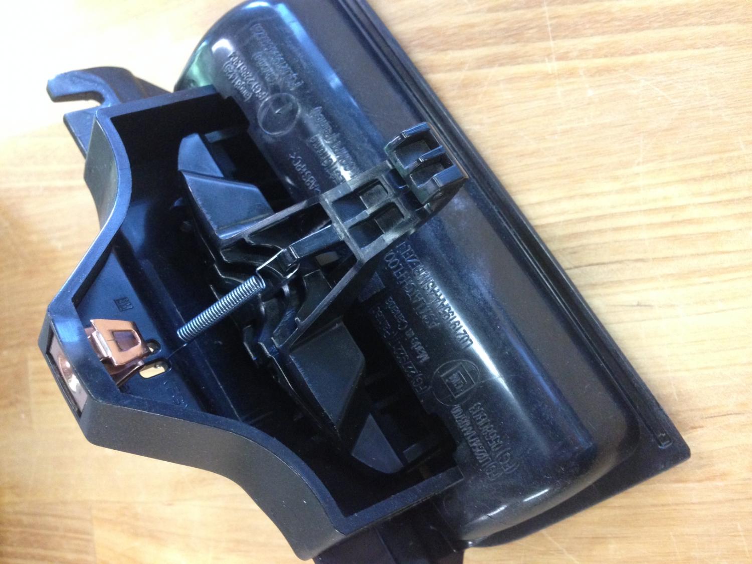

While you were in there, did you happen to notice if the latch could be swapped out? Mine is partially broken and doesn't always open the lid.
Looks like it is just held in by a plastic pin..
See this thread. If you are satisfied with the charcoal colored latch, I have a lightly used one available cheap.
http://www.gm-trucks.com/forums/topic/184299-2015-sierra-floor-console-latch-replacement/?hl=console&do=findComment&comment=2026506

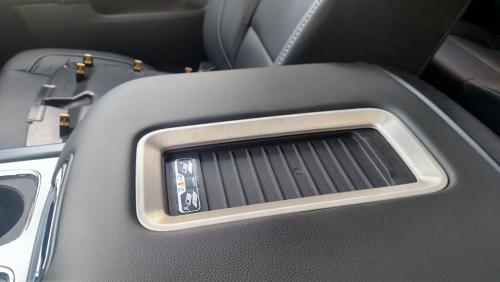

Finally got the console handle repaired and swapped out the console tray.
Here it is next to other "burnish" trim.
And here next to my OE Yukon SLT "axiom" trim.
