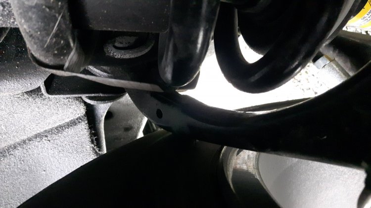

Hey I just got a 2017 Chev silverado 1500 I'm having issues with my wheel alignment I think. I got it done a week ago and 2 days ago I noticed that my tire is now a touching a part when I cut my wheel to the right on the driver side only.
Post your alignment spec sheet. Also do you have upsized tires?
