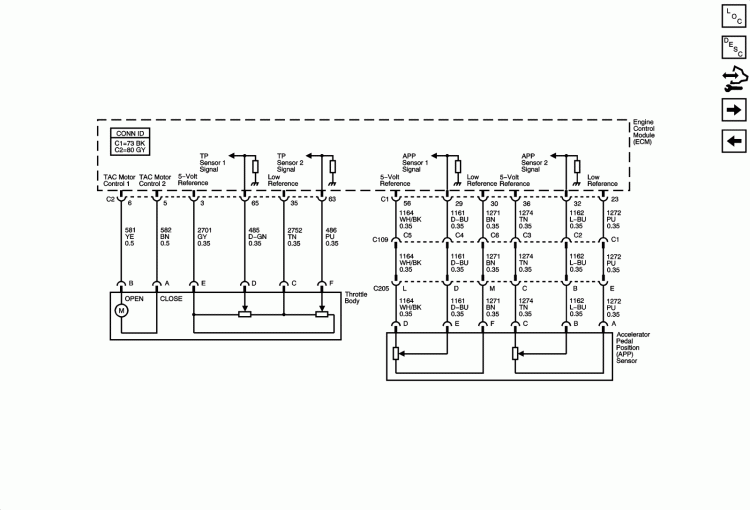

If it is a throttle position code and they through a throttle body at it and it didn't fix it most likely it is in the wiring (there is a GM Bulletin on the TB connector being a problem)
Personally if it were my truck and I had a TP1 or TP2 code setting I would replace the connector with (6 pin 88988106 connector - http://amzn.to/2zZAMvg) and run new wires from the connector to the ECM (you will need micro 64 terminals - http://amzn.to/2jQDc9A ) (you will need a terminal crimping tool if you don't have one - http://amzn.to/2A2blt9)
These wires run straight from the TB to the ECM so you should be able to wiggle test the wires and get it to act up. A lot of times what I see is where the wires go into the connector itself there will be a little bend and the wire will be white. I see this a lot on the yellow (581) and purple (486) wire. If you give it a little tug the wire will separate and you know that's where the break is in the wire.
This is just my suggestion without knowing any of the codes. I do all the electrical work at the dealership I work at and have been for the last 17 years.
Here is a schematic in case you decide to go that route.
