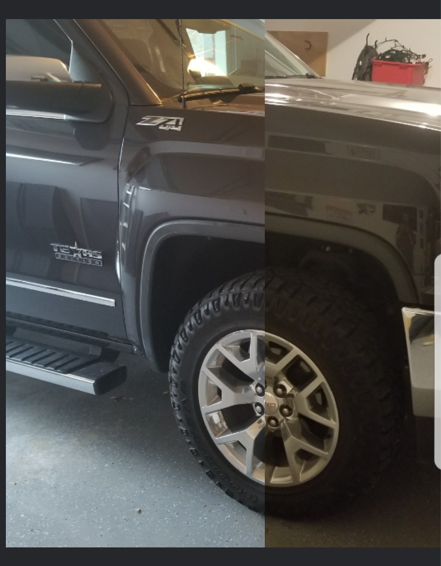

YouRock?NoIroc! Posted January 7, 2018 Posted January 7, 2018 2" is the way to go. Had it on my 2007 and just did it on my new truck. My 2007 wasn't 4x4, so the rough country spacer took minutes to install. I just had to remove the lower strut bolts and loosen the sway bar. I installed my rough country 2" leveling kit on my new GMC 4x4 last night and I had to remove the sway bar bolt and remove the top A arm to spindle bolt to slid the spindle over. This is because the front axle is in the way of the lower strut bolt. Took me 45 minutes each side, that includes drink breaks and talking to the neighbors. Rough country kit is $50 from auto anything and firestone is doing my allingment today for $80 (I bought the tires first to insure a good allingment). I did the same kit on the 07 back in 09 and its still going strong even with a teenager driving it for the past year.
