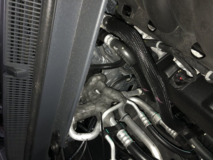

Big improvement. I can still hear it slightly, but I am listening for it and am sensitive from being tortured for weeks with it. But overall I am happy. I did look at where it comes into the firewall and feel the A/C line is conducting the compressor sound into the cabin as that is right where it is heard the loudest. Its a direct path from the compressor to the firewall. Bad design, but now with a quieter compressor I think I will look into sound insulation for the inside and maybe the outside to deaden it completely.

I had a '14 Silverado, '15 Sierra, '15 Yukon Denali XL, and now this '17 Yukon Denali XL. Never heard it till the '17. Although the '17 is improved in many areas from the previous trucks this noise is unnerving anf very annoying. It ruins the entire experience of owning a nice vehicle. It has to be the lines because the noise is the compressor and the noise is entering the cabin at the junction block on the firewall. I put a stethoscope on the line at several points and near the firewall and do not hear it. But under the theory of the 2 cups and a string transmitting sound, I cannot understand how it is so prevalent near the glove box inside but not heard in the engine compartment. It is definetly the second the compressor cycles on.  I bought some dum dum insulating putty which is heavy and dense and will cover the exposed aluminum line near the end at the firewall with the hopes of deadening and transmission of sound. ?? We will see.
