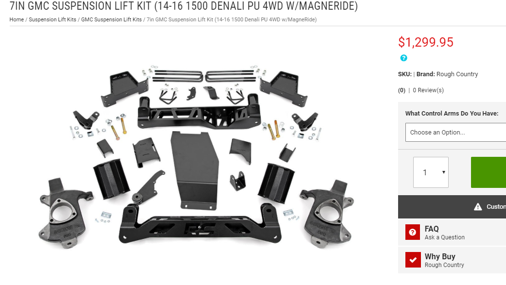

I'm a touch lost, When I went to Rough Country page, and then Filter down thru GMC lift, and Denali lift they have a 5 inch, 6, inch and a 7 inch spindle lift listed on their page. Is this information in-correct?  All three spindle lifts are the same price, listed at 1299.95 versus the one 7" bracket lift for 1399.95
Also if I was to go with a spindle lift has anyone seen if I would need to go with an aftermarket upper arm? I've seen a few other lifts  that of course do not include them but people are going with a better arm set up to accommodate the lift. Any Opinions on that? Or would the damn mag ride have me stuck since the leveling rod for the shock goes to the factory arm. Im sure I could just drill and tap, or weld the bracket in the right spot then have them re-powdered.. Or is it worth it to run an aftermarket upper?
Hmmmmm thats weird. I just took another look at the rough country site because that kit wasn't coming up for me. It looks like when you input 2017 denali 4x4 it only gives you the option for the 5 and 6" spindle kits along with the 7" bracket kit. When you change the year to a 2016 denali 4x4 if give you the option for the kit you posted.
Regardless though the kit still isn't compatible with factory stamped steel control arms. If you have aluminum control arms then all the kits listed are compatible.

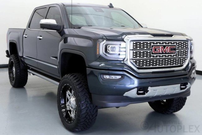

No problem I had to go back and double check for myself because I hadn't seen the kit you posted. I found a couple dealers selling lifted denali's with the Full Throttle Suspension kits installed. Im trying to decide which to go with but Im leaning towards BDS.
Heres a pic of one of the trucks running a FTS kit for sale at a dealer.
