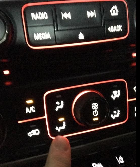

If you push this button on a 2014+ GM/Chev, does your truck keep blowing an annoying amount of air out the defrost vent? I had heard there were updates to the HVAC module, but don’t know if it changes the behaviour. If yours is newer and doesn’t blow out the defrost, lemme know so I can take it to the dealer. I had been dealing with it, but now tired of the extra noise, surprised it works this way. That button implies floor heat only, no?
I dont think its actually blowing, maybe just sounds like it is. Its the same sound when its on floor/defrost, but just no air coming out defrost? Just crappy that it has to be that loud. I end up turning it on floor and dash vents, and then just close the dash vents. Makes for a much quieter ride.
You might be missing some piece of insulation that goes around the valve? If no air is coming out of the defrost then I would think its slightly normal?
I’m thinking they have a small opening so a tiny bit of air always hits the windshield. I hear it from the dash when it’s on HI! But the lower the speed the less I hear it.
Mines a 17
could lay a piece of paper or a tissue to see if it is noise or air.

As my '18 just started doing this yesterday.  I traded in a ford....because I got mad it it after having a blend door actuator replaced 3x under warranty. My gmc did Not use to have this wicked noise coming out of the defrost vents when " floor" or "floor/dash" was selected....but it does now. Extra noise drives me Crazy. 20k miles on it.  I'm dreading calling the dealer. They won't have whatever it needs in stock, if, they even can determine that it has a need.  They'll most  likely tell me it's normal, or that "technician unable to verify concern".

Has anybody had this repaired? Was it the switch? Sensor? Blend door actuator?

Question, are you sure the noise is coming from the vents?
Have you ever changed your cabin filter, if debris gets caught in the filter, or in the blower fan, it will make strange noises increasing with fan speed.

I have not. But it's not a something stuck in fan noise. It's defroster blowing Up when it shouldn't be noise.  Sound goes away 100% when switched to "floor/dash".  But it's still there when switched to "floor"
I just tested it a bit to verify it is indeed blowing air up through the defroster when it is suppose to be just directing it to the floor.  When I select "floor"....it will blow a sheet of paper right against the winshield. When I selct "floor/dash" it doesn't
