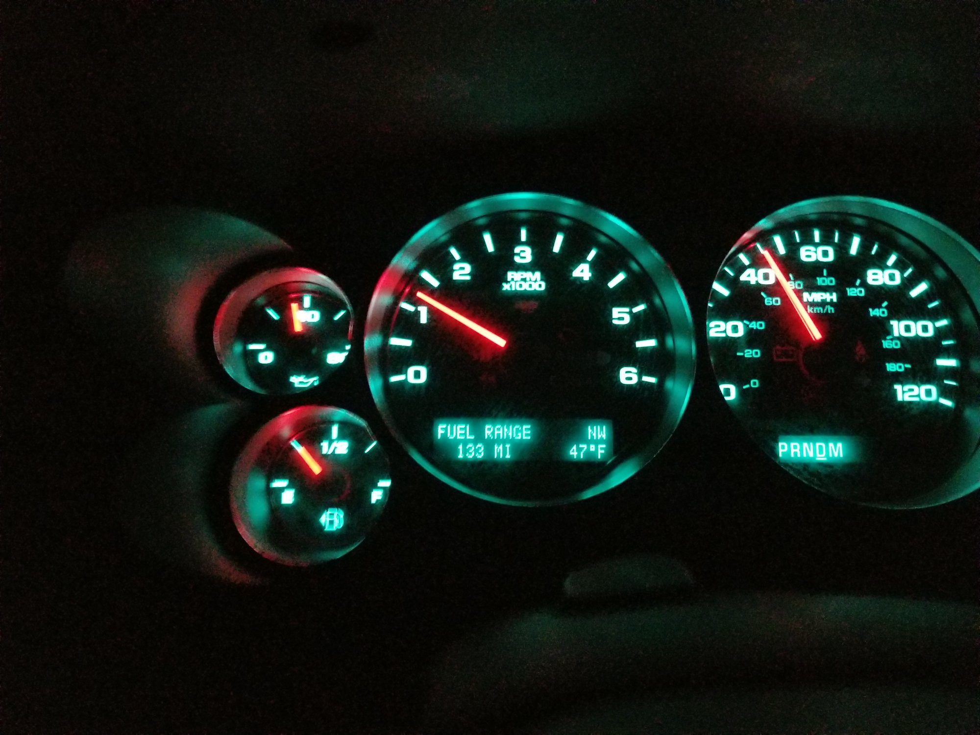

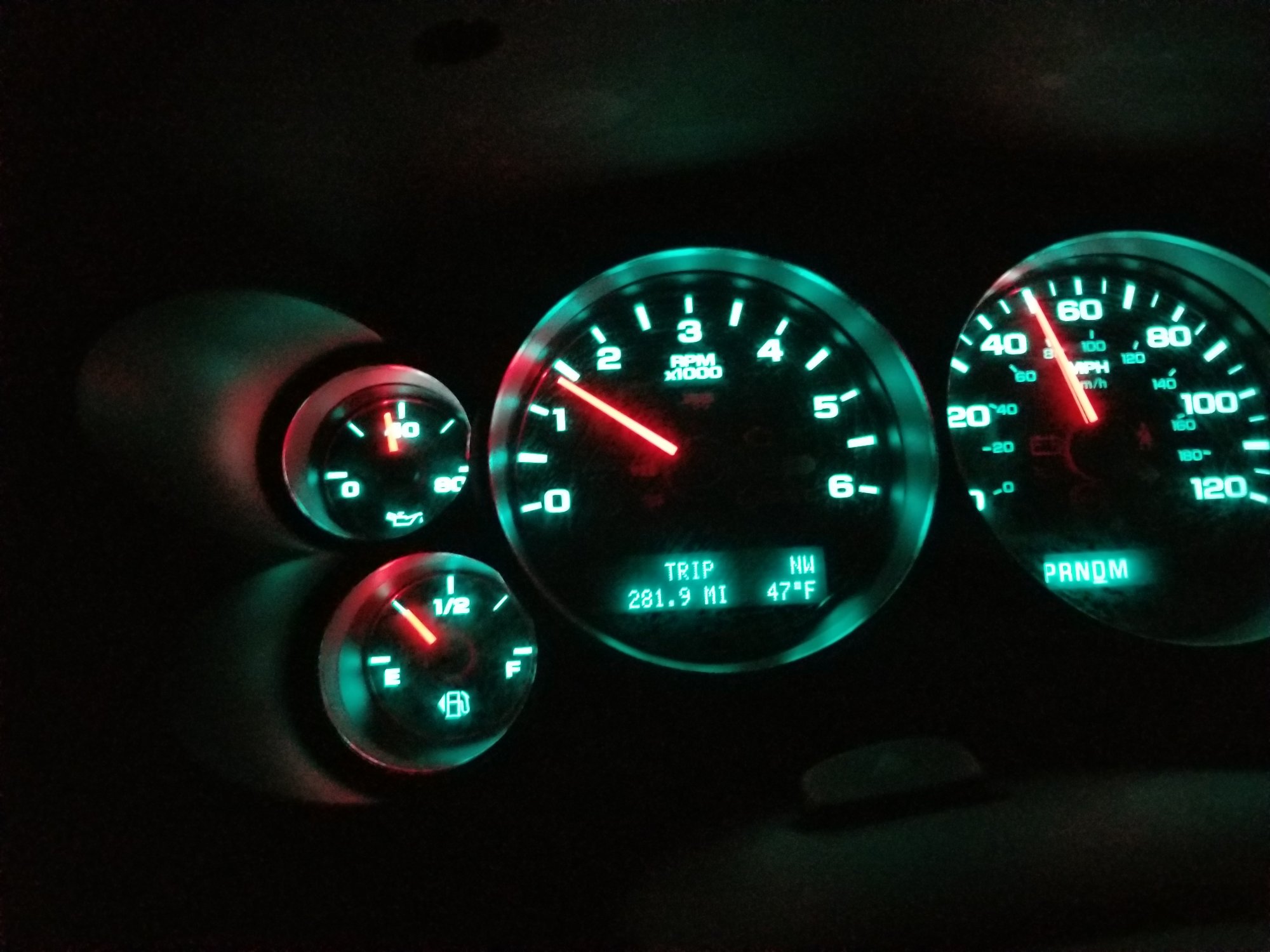

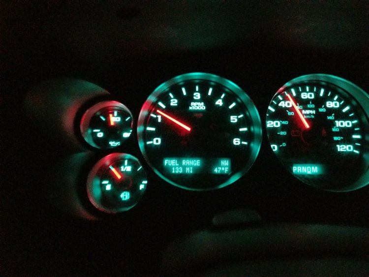

So here's 2 shots, trip meter and remaining fuel meter. I am actually seeing the average mpg go up slowly but it hasn't been reset in 10000 miles or so. Keep in mind this is some true stop and go traffic in the afternoon, took me 1.5 hours to go 32 miles yesterday.
