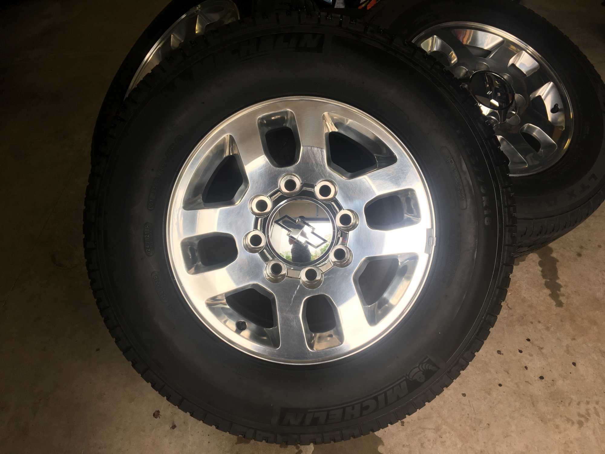

Wish I would have read this sooner. I just bought new wheels and tires myself. General Grabbers on Gear wheels. The old TPMS sensors are still in the old tires. The good news is I have he old ones to sell if any one isinterested. A little life left in the rubber. They’re in excellent condition.
