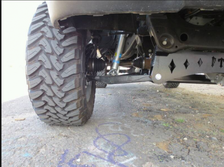

Bracket lift i reference the lift kits that include new crossmembers that drop all your components down so that you keep stock angles. The rough country 6" is essentially a 4" lift with a 2" spacer added, if you dont add the spacer your truck will be 4" taller and still maintain all the factory ball joint angles/tie rods/ etc.
Lift kit example - image.png.0d383138611d0b493b6ca2469666f26b.png any kit without the crossmembers/new knuckles is going to put your angles in a bind..
This is what a REAL kit will make your angles look like image.thumb.png.6865fa875090d9a776c490035b83675b.png
Heres what a stretched level basically makes your angles...
That helps alot. In the first picture is that a "body lift" or is that a lift similar to a 6" rough country like you were saying. Also in the second picture could you explain why the angles are so bad.
No not a body thats a suspension lift like the rough country lift I suggested. The second picture is what happens when you buy a kit that does change the angles of your lower control arms, most of which are the 3-4" "LIFTS" they are essentially massive leveling kits that ruin your front end.. I have a 2.5" front level and my angles arent terrible but I would not go above it..
