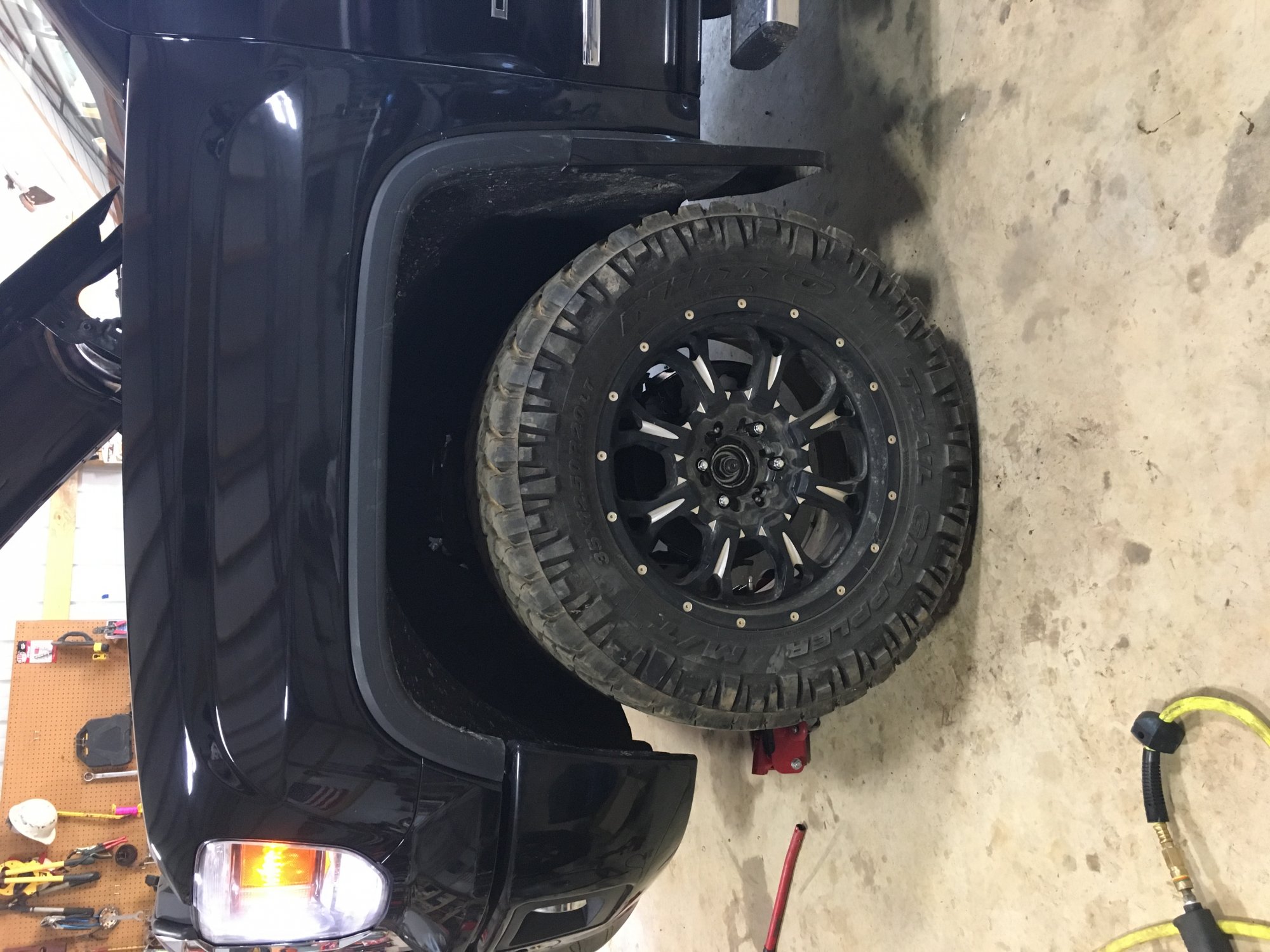

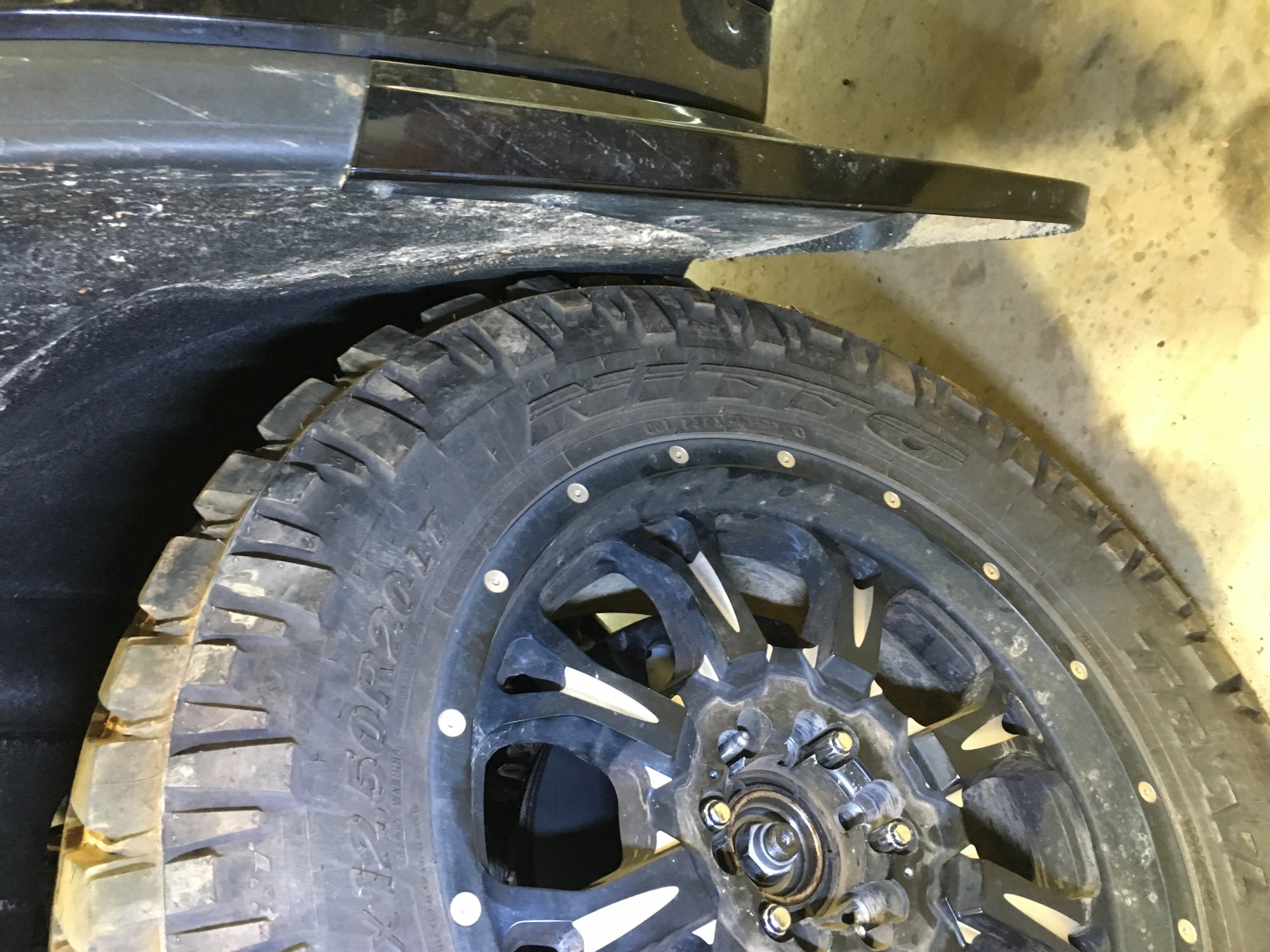

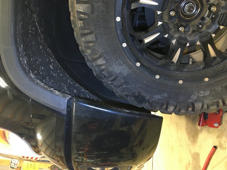

@texasaggies16 I took some pictures of what I'm dealing with today. These are 35" tires with an inch leveling kit.I feel like if I got a 2.5" leveling kit, I could clear 35's.
I mean you could probley stuff them and have minor trimming/do some zip ties but I bet those things def rub backing out of a driveway ha. If you just drive on the street you might can make it work.. Are your 35s mud tires?
Yeah, they are Nitto Trail graps. I do go to my huntin club a good bit which has holes,bumps, ect.. so I need to have some clearance. I guess I will have to break down and buy the 1000$ lift kit or go to 33's with a 2.5" leveling kit.
Yeah if you are going down a road with bumps and holes and so on you are going to need a 6" lift for 35's or a 4" lift and trim a bunch of pieces. Anything less than 4" and you are going to have major rubbing issues on any slight incline.
For a Denali I would highly recommend the BDS kits w/ fox coilers, if you can spring the additional cost.
You are going to get a stiffer ride with a leveling kit and 2.5" is pushing the cv angles, 3" is too much and 2.5" is getting there. I don't recommend doing more than a 2" level.
