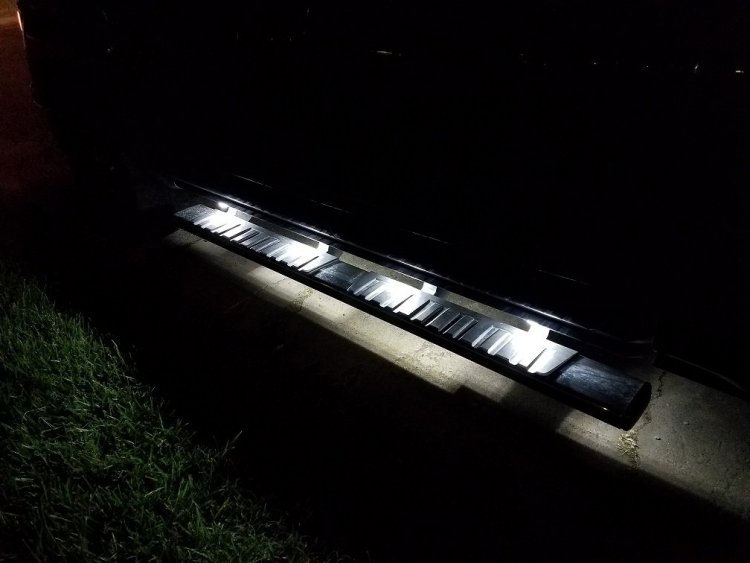

I’ve done this already, there’s a rubber grommet right under the driver side door, so put the led strips under your doors then run the wires though there inside of your cab, then just splice into your dome light circuit; beyond easy mod that looks amazing. I also did the footwell lighting when I did this one.

I can't remember the brand but I bought them at AutoZone for like $25. They're meant for the truck bed but I already had some in there and figured these would work great, and they did. I wired them in with the courtesy lights so they come on with unlock or opening a door.

I used stips outside then single little pod lights inside. Just 4(2 in front end 2 in rear)!
