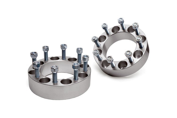

If you get rubbing, it pretty easy to trim. Or you could buy a set of spacers. Not only do they eliminate rub, but they also give your ride a wider stance, which makes it more stable and improves the aesthetics of the truck.
If you use slip on spacers, make sure you torque the lugs properly and re-check after a few miles.
If you use bolt on spacers, you MUST follow the manufacturers installation instructions precisely.
