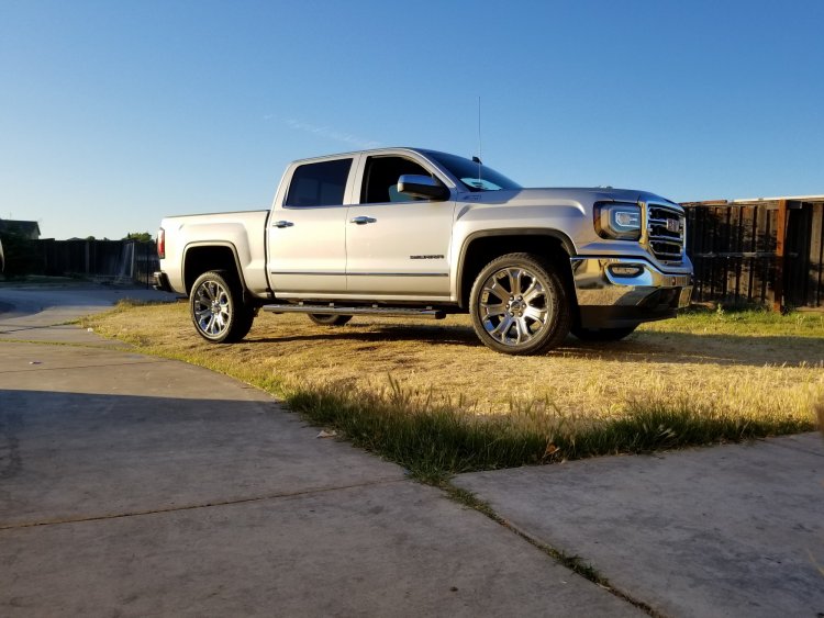

Should I lift or level it out?
20180620_194322.thumb.jpg.d89948418ed047ce920a63c2439012b8.jpgHey guys I want to keep my stock 22s but put some meaty tires on them. Would I have to lift it? Or can I get away with just leveling it? If I have to lift it what is the best lift kit on the market? But if I can get away with a leveling kit which is the best 1 in the market? And what are the best tires?(if they make meaty 22inch tires) It's a 18' by the way
