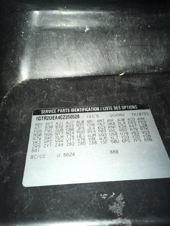

I have been talking to a very nice lady that has a mint 2012 Sierra it was all going well until she told me it has the 4.8L V8. It does have the Tow/Haul button on the gear shifter and she was kind enough to send me a pic of the page from the manual which shows the 4.8L V8 has either 3.23 or 3.73 axle ratio along with the RPO sticker. I saw GU6 which I thought was 3.42.
I have included the 2 pics, Am I reading the RPO sticker correctly?

Yep, this one has a 3.42 gear (GU6) and the external transmission cooler (KNP) by itself.  She's on the wrong page, a K10753 is an 4WD Extended Cab with a Regular Bed.  Tow ratings are the same, 5,500/11,000.
Good things about this truck is that is a simple truck, not a lot of bells and whistles to go wrong and the motor (L20) does not have AFM.  Put a 3.622 crankshaft in it and it becomes a 5.3!
The L20 does not have AFM, does have VVT and is FlexFuel capable.
