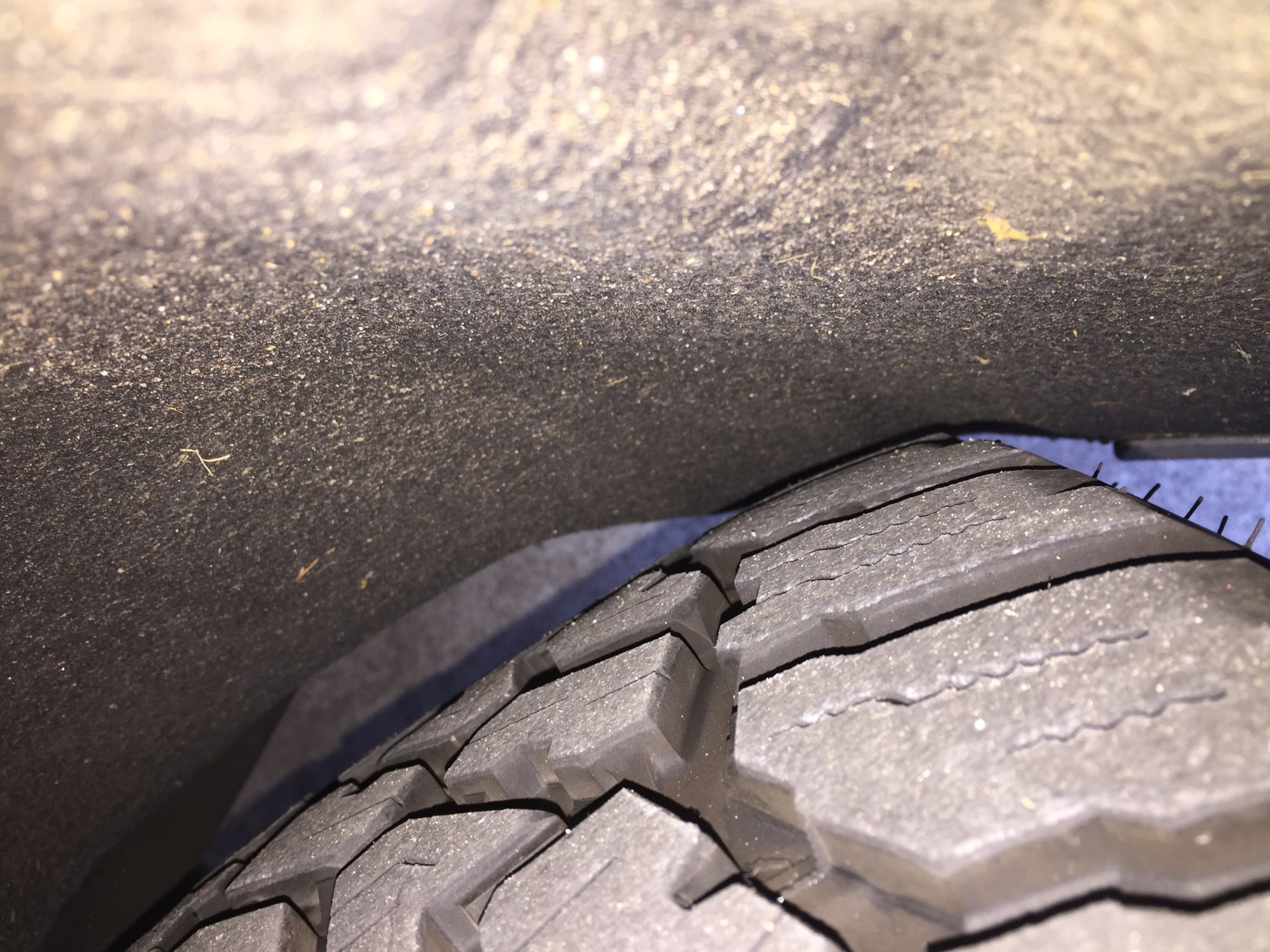

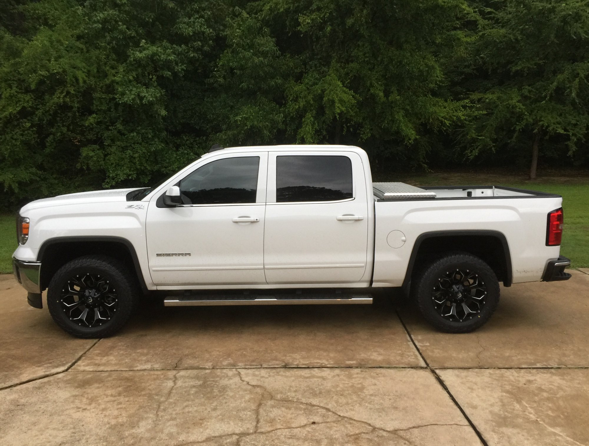

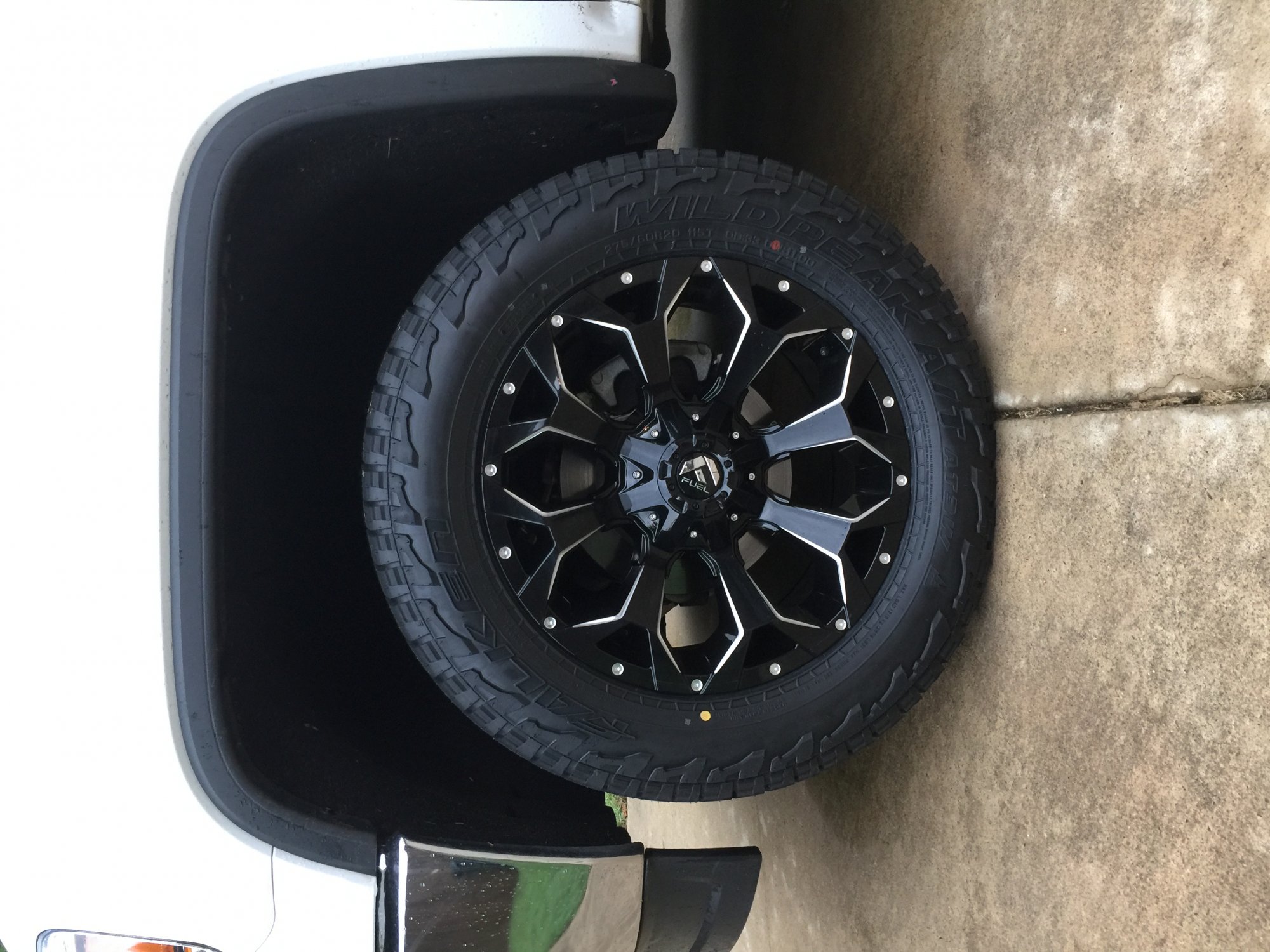

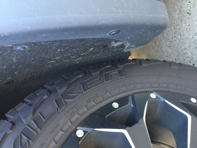

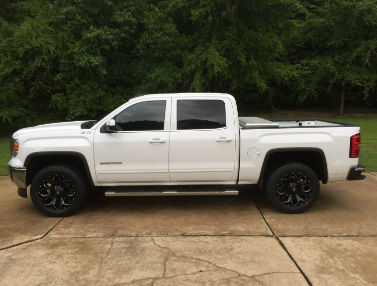

I installed bilstein 5100s a few months ago on the highest setting on my ‘15 Sierra Z71 with 20x9 Fuel Assault rims with a +1 offset. I have 275/60R20 Falken Wildpeak AT3 tires. They rub the mesh wheel well liner slightly at full lock (I believe this is due to the +1 offset). I wanted my tires to stick out slightly past the side of the truck.
I measured up up to the top of the wheel well before and after the install and these are my measurements:
Front
Before: 35 1/2”
After: 37 1/4”
Rear
Before: 38 1/2”
After: 38 3/8”
Lifted front end 1.75”
The  back end is 1.13” higher than the front.

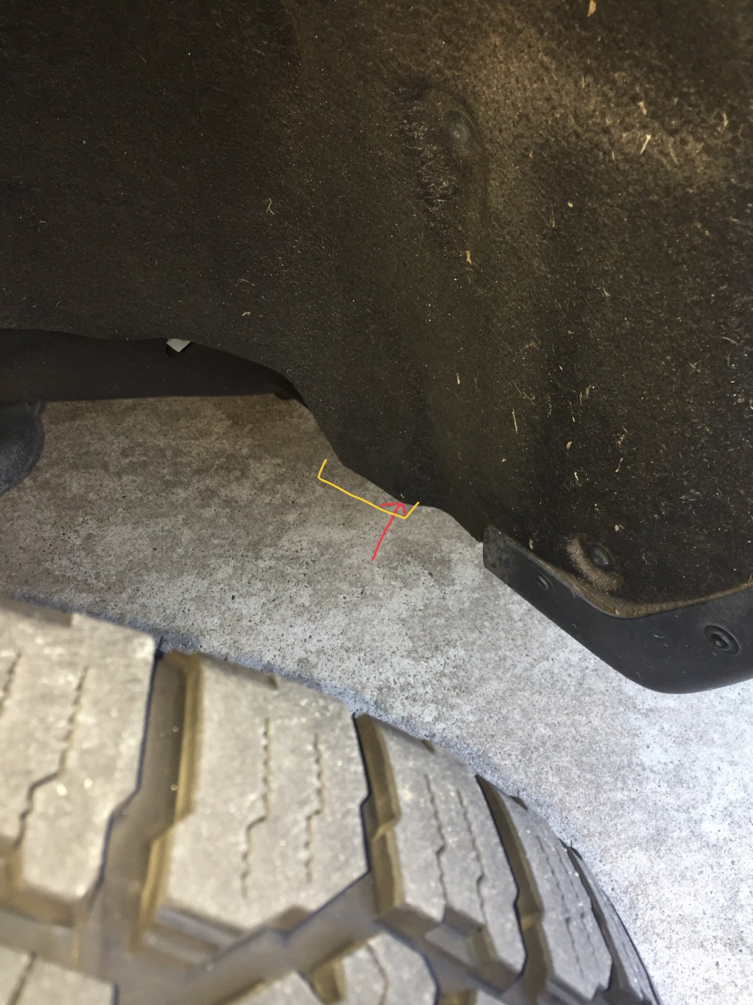

So from what I'm reading, if I use the highest setting on the Bilteins the tires will rub.
In my specific setup, yes. I did research for months before I made my purchase. I found people that said their 20” rims with 33s fit with no rubbing with bilstein shocks, but everyone left out rim offsets and actual tire width and diameter. I was pretty confident my setup wouldn’t rub, but it did. I believe the reason my tires rub is because I chose a +1 offset. The factory 20s have a +27 offset, so my wheels/tires stick out a little over an inch from a factory location. The outside edge of the tire tread rubs (at the red arrow in the picture) because about 4-5” of the liner (yellow section) protrudes in about an inch. If I chose a rim with an offset close to the the factory offset, I believe they might fit without rubbing. I’m also posting a picture of some different brands of 35”x12.5” AT tires. You can see there’s obviously some differences in width and height from different manufacturers. So a lot of people say “My XX” tires did/didn’t fit without rubbing with an XYZ brand of lift” and this is part of the reason why imo. Everyone’s statements are generally too generic. Unless you find someone with the same exact setup you’re looking for, it will be difficult to say it will/won’t rub.
With that being said, I did just as much research on the bilsteins as I did on the rims and tire combination. Based on all that research, I think they’re superior to a spacer lift. So, I pulled trigger and bought my setup. Initially, I was upset because my tires rubbed a little, but after a few  weeks, I’m happy I went with the bilsteins. There’s nothing but air behind the liner where they rub, and I can trim the liner so there’s no rubbing if I want to. The main thing is, I don’t have to trim any metal or plastic. Also, the ride quality is better to (even my wife thinks so).
Bottom line, if you go with bilsteins, you’ll get less than 2” of lift in the front of your truck and you’ll run the risk of rubbing with 275/60R20 tires.
The outside edge of the tire tread rubs (at the red arrow in the picture) because about 4-5” of the liner (yellow section) protrudes in about an inch. C316F659-CE7D-4D12-99B6-EED2855CFC1B.jpeg
These are different brands of 35x12.5 AT tires. You can see there’s a difference between the height and width from different tire manufacturers.
