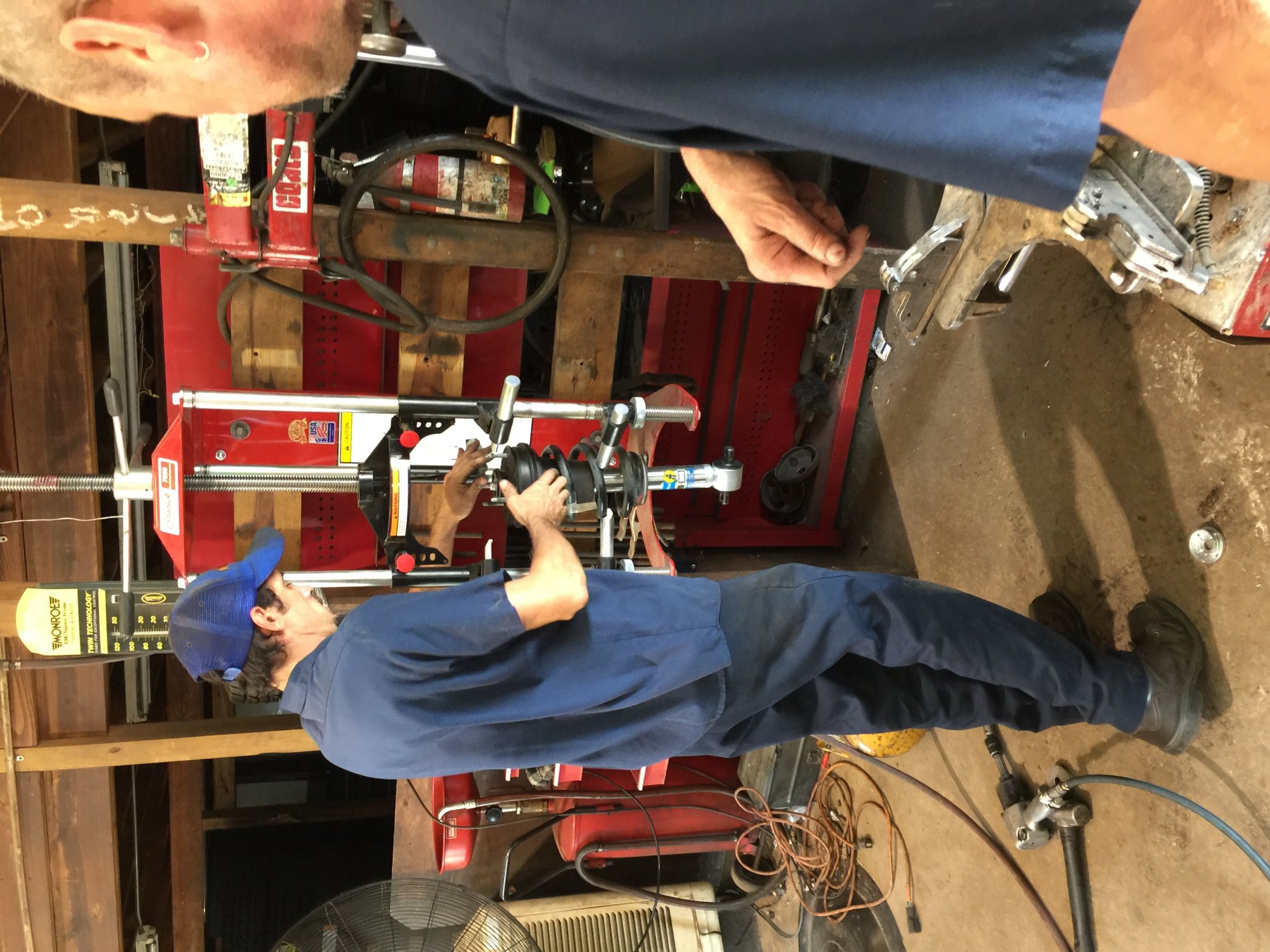

I installed my kit myself except for compressing the springs. I took them to a local tire shop and they had the right setup to safely compress the springs. It cost around $60 for them to do it, but I wasn’t comfortable doing it myself because the rental tools from auto zone were too small to fit it properly. DB51602D-54B6-4AC7-9C44-E1A84F786611.thumb.jpeg.d42a3782b04ea579b6c062811d08c988.jpeg
