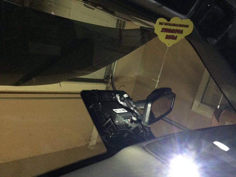

This may, or may not apply: Check the camera that is attached to the rear view mirror and the windshield. When my windshield was replaced, the camera stopped working, kept getting service stabilitrack message, and I believe the abs message, too, and lane departure rumbler in the seat stopped working. I unplugged the camera and ran the truck and later reattached the cable to the camera, and it reset itself. I ended up keeping the two plastic trim pieces off and the Stabilitrack issues went away. 14 Gmc Sierra Slt. Picture is upside down.
