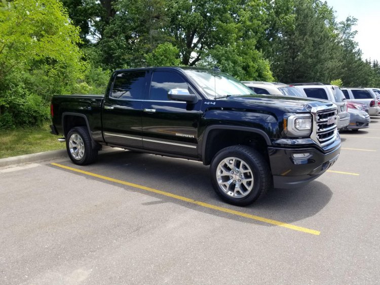

I am not here to argue but will post my thoughts here. I cannot speak to longevity of parts etc as I just recently installed my kit. I fully understand that ball joints and tie rods will have a shorter life span than that of a true 4" kit as they drop everything down and keep all angles stock. I am aware of those facts and consequences. I already had a readylift 2.25" leveling kit on my truck and wanted to go with the upgraded upper control arms as the stamped steel I had are not recomended to run on a leveling kit. I figured for a couple hundred difference I could get the 4" Fabtech kit vs just upper controls arms so figured what the heck, I will give it a try. I can tell you my truck rides absolutely no different than it did with just the leveling kit. I can also note that the Fabtech budget kit is misadvertised as a 4" lift. My truck is 3" higher than stock out front. The first picture shows my angles with the 2.25" level. The second picture is with the Fabtech kit installed. Once again, I will not argue that this kit is better than a true 4" lift because it isn't, I also don't feel it's garbage either but to each there own. Just putting my experience out there. I know others that have run 3.5" kits such as the Rough Country for 3+ years without issue.e4cb999fb2724b28fd3fecf69a9cba39.jpgd6e31438e7f99f4ba0d4f54d7889dc5d.jpgbf8578e03e8bb6e4ebfd6ff098786ce0.jpg

I got 3.5" of lift.  It rides just a tad stiffer than stock.  I am running the stock 20" wheels/275/55-20 tires.

If I was coming from stock I would do this kit again. Knowing what I know now, I would probably purchase the Zone kit simply for the fact that this kit was too much work to go from 2.25" to 3". That being said I am putting a lower spacer back in to get me up to 4" because that's what I was going for. I will report back with how that changes my anlges, ride, etc.
Sent from my SAMSUNG-SM-G890A using Tapatalk
I figure if worst comes to worst I already have the control arms and upgraded shocks for the rear if I decide to do a true lift. Control arms alone would have been $500. I paid $710 for this entire kit plus $60 for a Zone add a leaf. Keep in mind with this kit it only comes with a 1.5" rear block. Thats only .25" lift as these trucks have a 1.25" block factory.
