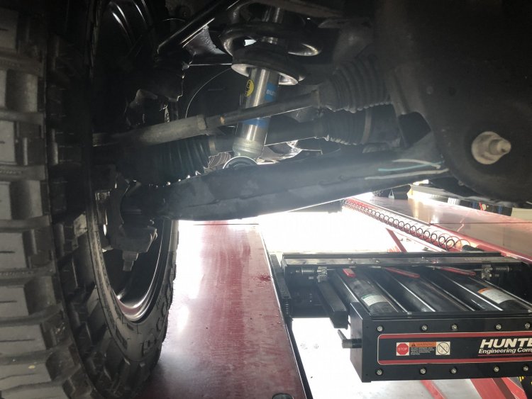

thanks everyone, right now I'm planning on getting the RC 2.5 kit, adjustable bilsteins, and possibly zone add-a-leaf to fit 275/65r20 Falken AT3's (although I'd like to get something a little wider, but we'll see). OH and no UCA needed for this set up correct?
I will warn you that my 275/60/20 falken tires rub UCA at full lock with max height bilstein. Has to do with the stamped arms pulling higher when leveled. 275/65/20 will likely have the same problem.
Also, if going with the full 2.5 level it, definitely keep b5100s at stock height. 1st notch will stretch it close to 3".
do you think a ziptie to the fender liner would help or would it need more?

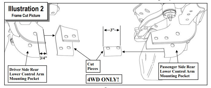

Which Zone kit?  The 4.5"?  You are going to have to cut off the mounts from your front diff, and a piece from the cross member.  I would run a full kit if I didn't have to cut so much.
On 9/10/2018 at 10:40 AM, Denali34 said:
I had the Pro Comp 4" lift installed on mine and its a very nice kit. I have the factory 22" wheels and was able to keep them without spacers. I had it installed for $3100 out the door. It also has a $250 mail in rebate thru Sept. 31st. Here is the kit. You can see by the components that they lift it the right way and si 100% returnable to stock if need be. Its a true 4" lift as well. I acutally got 4.2" in the front and 4.4" in the back. https://www.procompusa.com/suspension-product-details.aspx?pt=3533&pl=1808&partno=EXPK1173B
Are you sure about the returning to stock?  I have yet to see a kit that doesn't require cutting of the differential.
Yes sir. There is no cutting of the differential and all the mounting tabs are left intact. That’s the main reason I went with this setup besides keeping magneride.
That's cool, found the instructions and it does say to cut the frame though.  Well for 4wd anyway.
Not the liner, the UCA itself makes contact with the inside face of the tire.
