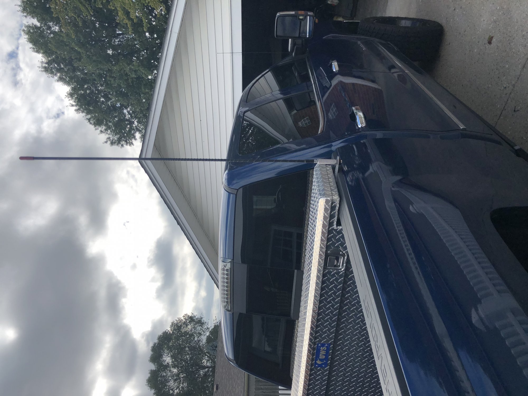

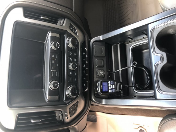

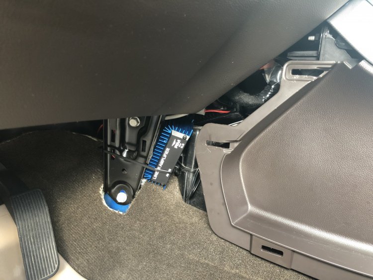

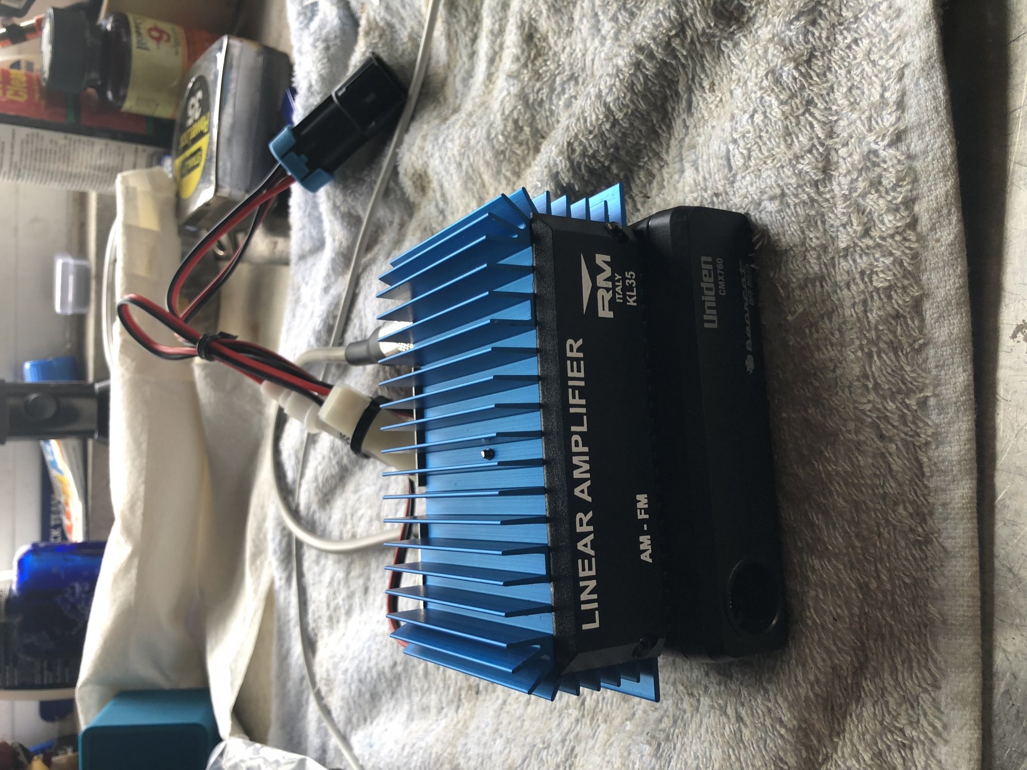

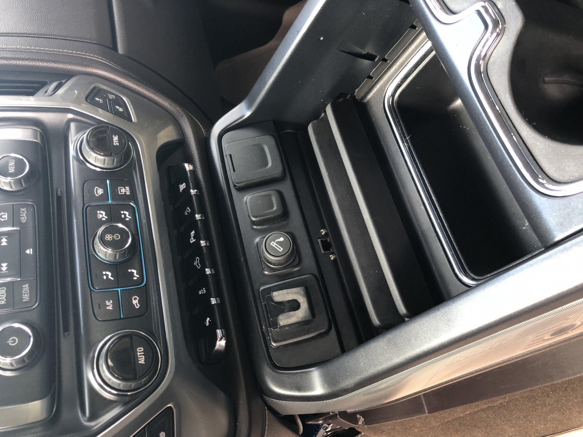

I’ve had a radio installed in my truck since I bought it in 2015 but decided to upgrade my radio setup and figured I would share some pics of the install. I had originally had a Stryker SR-89MC converted to 11m but upgraded to a Uniden CMX760 with an RM KL-35 linear. 4ft firestik is tuned for a perfect 1.1 swr...dead keys 21w and swings to 30w. It is a clean install that isn’t bulky and you can remove the mic and unscrew the antenna and you’d almost never know a CB was installed if you ever needed to. Sorry the pics are sideways, I posted from my phone and don’t know how to rotate them to post properly.

How does it sound? Isn’t the speaker in the bottom on the CB?
This radio has the speaker on the mic. But I am running an external speaker that is mounted up under the center console with the CB. It is very easy to hear even over music on the radio.
