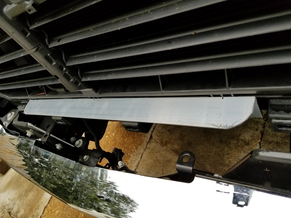

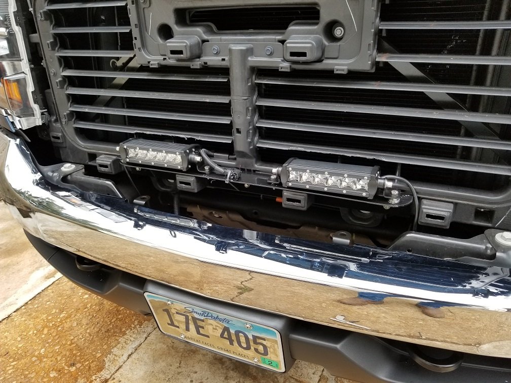

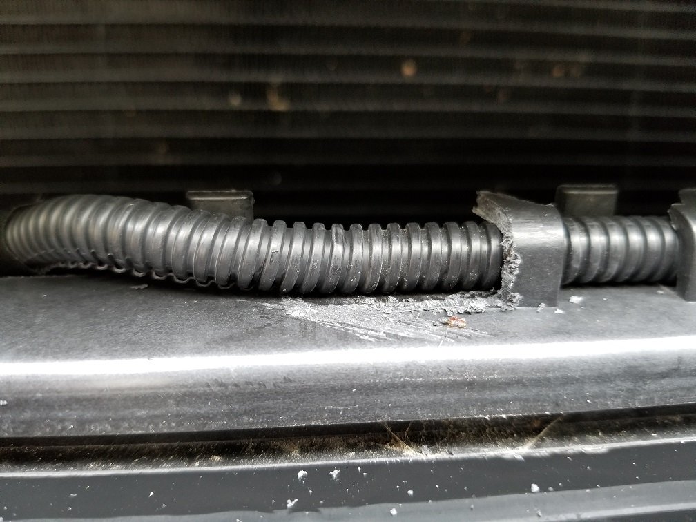

Here is my solution to fitting LED pods behind the grill with the Active Shutter System.  I had to trim the two lower shutters, the wire retainer for the ambient air sensor, and the shroud behind the grill.  I used 2 6in single row bars from Rough Country.

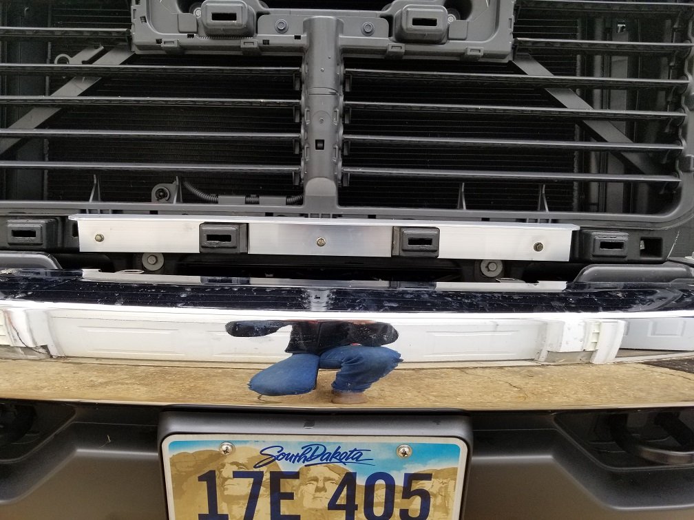

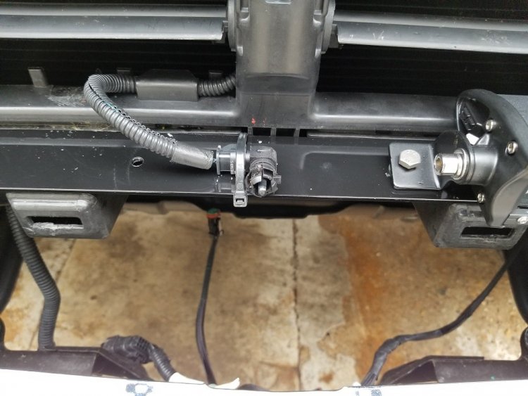

Started with a piece of 2x2 aluminum angle iron.  I decided to relocate the ambient air sensor so that it was not blocked by the light.  I may still make a bracket to bolt on to the angle iron to better hold it.  There is no shadowing from the grill on the lights.  All I have left once the rest of my parts show up is to run the wires to/from the Offroad Light Switch following @TinkeringFox's how to video once I get the rest of my parts in the mail.

Did you remove the shroud around the shutters that attaches to the grill?
No all I did was trim it to go around the light mount.
