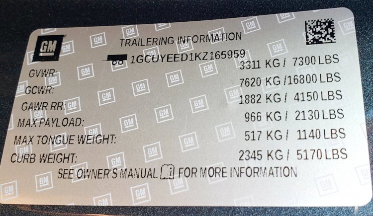

Went by and looked at a few this weekend and they had a RST Allstar edition 4x4 with the max trailering package.  I was surprised to see the specs... pretty respectable!
