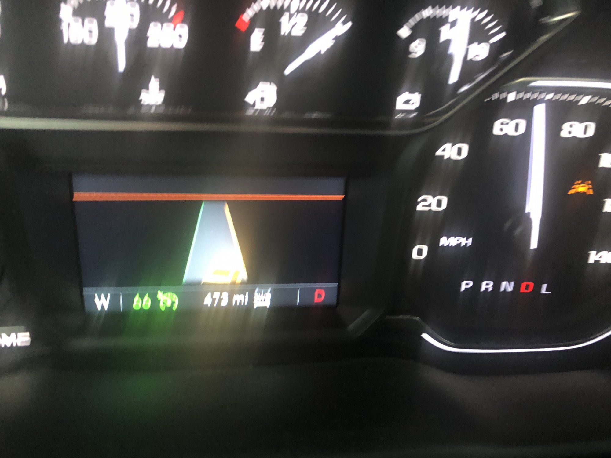

My 2019 Sierra SLT Lane Departure Warning
doesn't seem to be working right - here is the GM description of it's operation
1• When a left or right lane marking is detected, a green icon is displayed
2• If you let your vehicle drift over a detected lane marking without intentionally steering or using your turn signal, this icon turns amber and the system provides brief steering wheel inputs to help guide you back into your lane; this can be easily overridden with normal steering
3• If lane drifting still occurs, the Lane Departure Warning system will flash the amber icon; in addition, the Safety Alert Seat pulses on the left or right side.
my issue is on #3 - when the amber icon flashes, my seat seldom pulses - my 2014 - Z71 seat pulsed EVERY time l crossed a lane marking unintentionally which really gets your attention
I'm wondering if all the 2019's have the seldom pulsing seat like mine or do they normally pulse every time the amber icon flashes.
