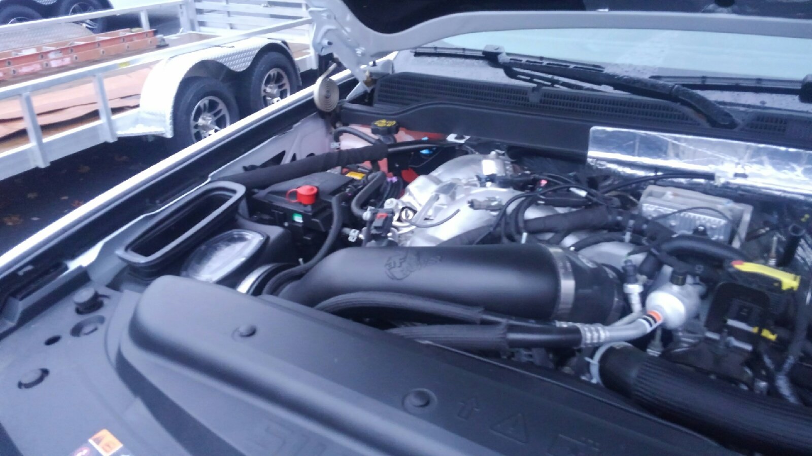

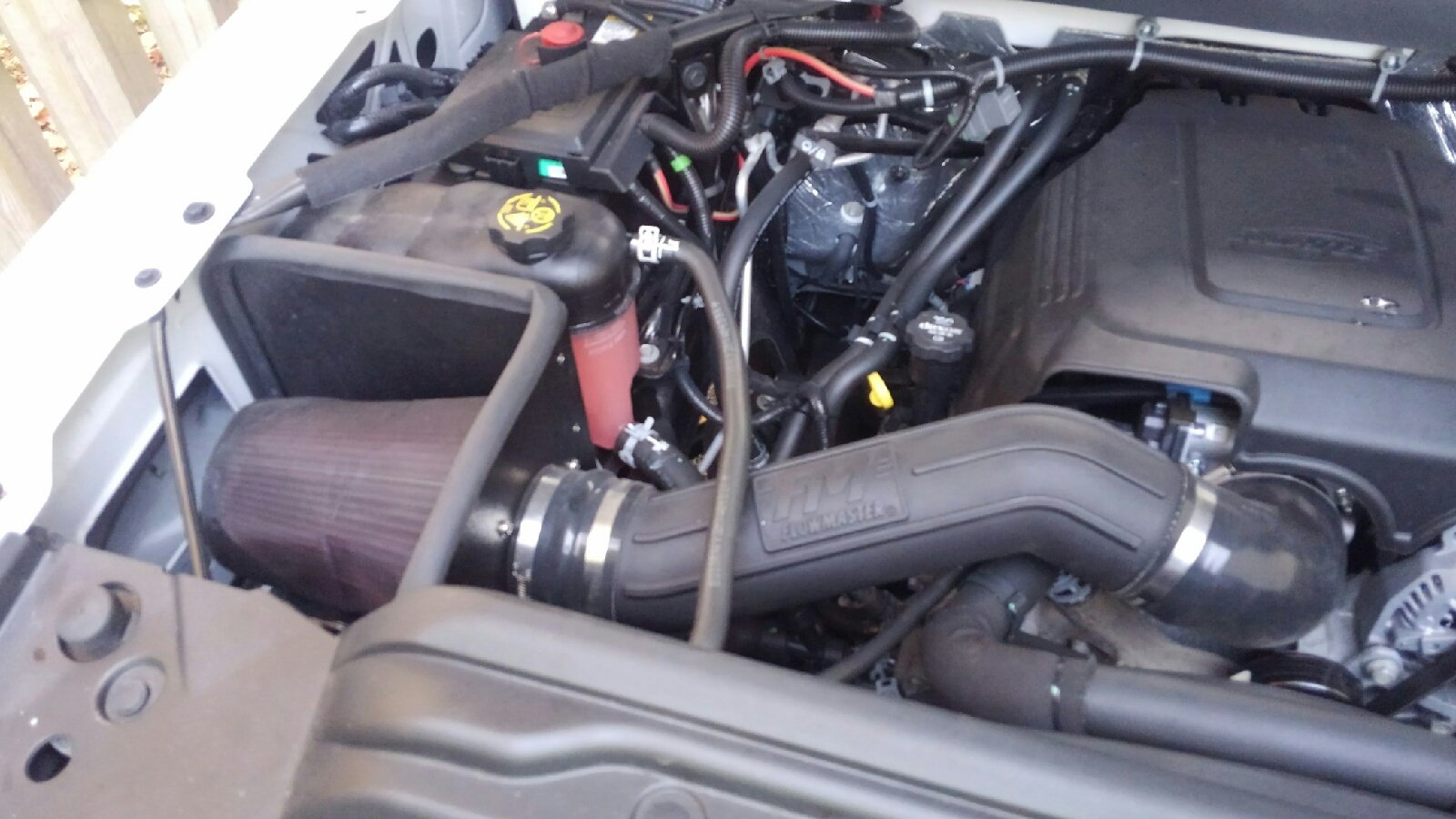

It did it with flowmaster sytem  2 only after that volt issue  at about  1190 - i installed all mods flowmaster air box ,mbrp system & airid spacer right around 280 miles right after i bought it brand new in june 2018  - it ran great

Those are 2 afe system air box is for dmax - airfilter & tube(pipe) for 6.0 & 2 4"90's & sleeve is from spectre to make fit

Gotchya, I was looking at the intake prior with the box that matches the hood, I'm not going to lie I've had 05's through 2011 , and these new gens 2015 up gas jobs feel alot sluggish compared to the older models.... the dealer didnt notice your truck basically falling on its face ?
