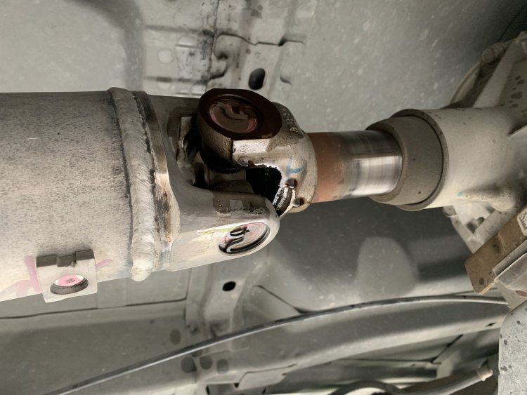

Recently lifted my truck 6.5” and when I pulled it in the drive way I notice a puddle of oil under. What’s the proper fix for this problem .
at first I thought a bad seal but the seal seems to be dry and looks like it’s leaking towards the end of the yoke.
Im a newby on this forum anything will help thank you.
Edited by King chuy
maybe guys that have  that lift can answer this but to me your lift has your driveline angles wrong and you need a new ujoint but even worst is how far it pulled the shaft out of your transmission
Edited by silveradosid
