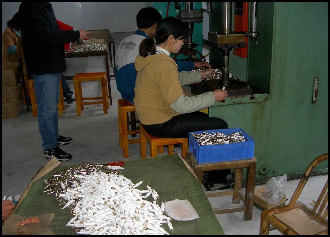

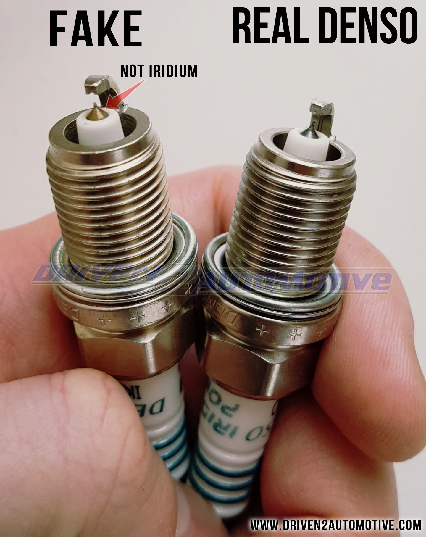

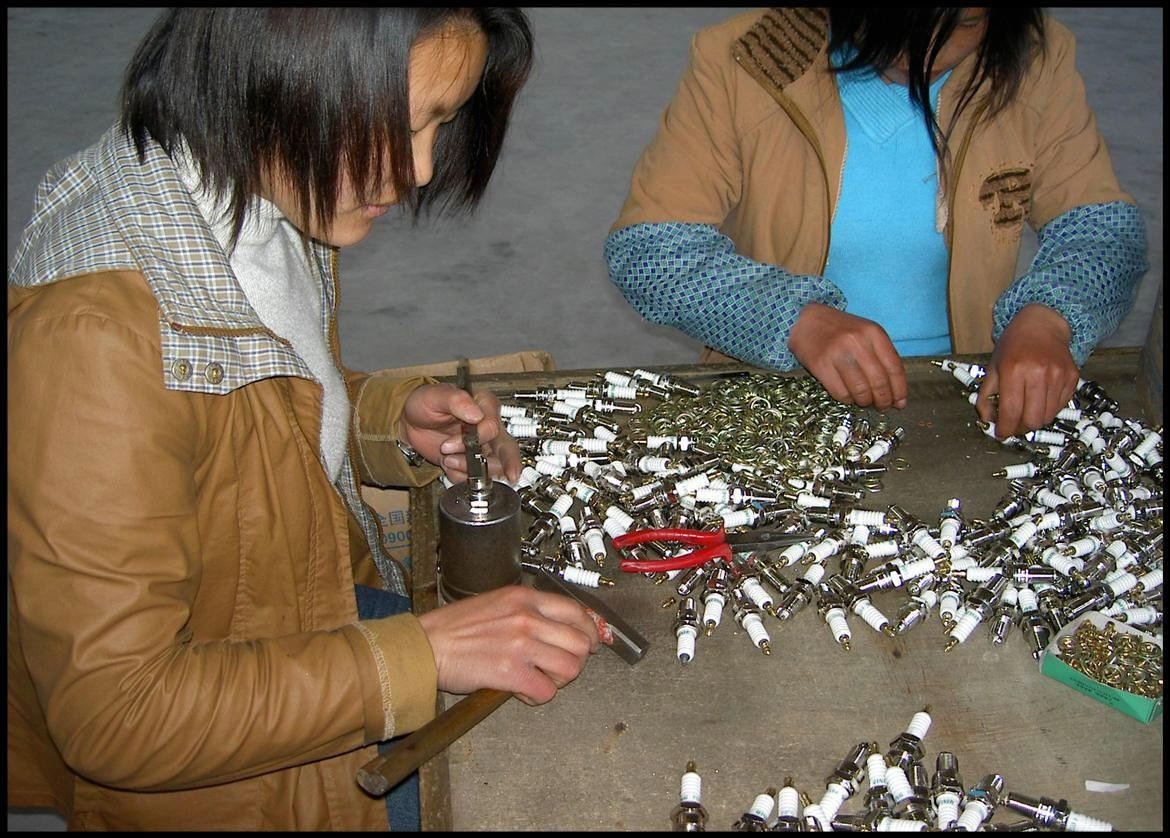

yeah, $3 each for iridium and $2 each for the double platinum  It would cover RockAuto's shipping.  I'm really looking at the ones on Amazon as possibly being fakes.  One of the reviews for one of the sellers said so explicitly
OEM or AC delco..
Don't use any other brands.
I'm speaking from experience!
