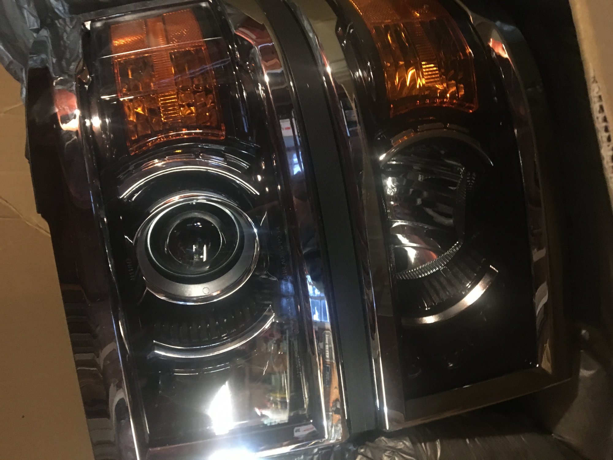

I have 1 driver side eagle eye headlight that i would sell if anyones interested, the headlight is in great shape, the only deal is the projectors squirrel finder needs adjusted. 80 shipped
