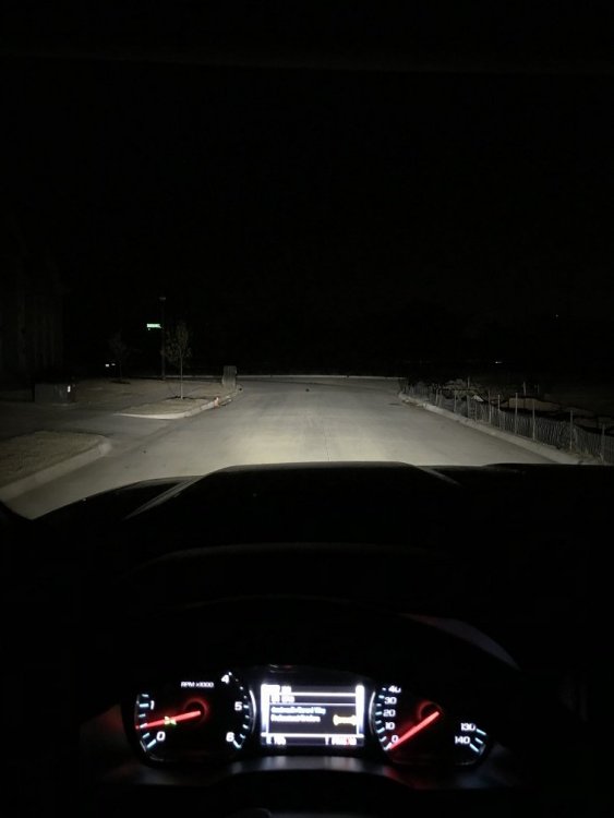

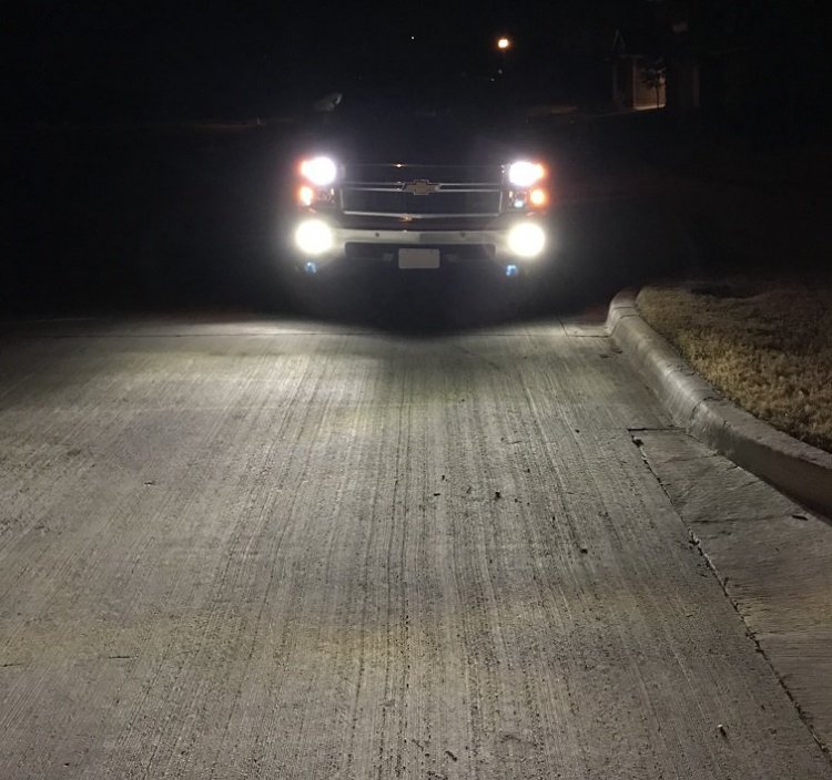

KNIGHT1 Posted January 2, 2019 Posted January 2, 2019 1 minute ago, btj_z71 said: If it is a projector style housing, you will have to use halogen or HID. LEDs do not perform well in projector housings. I have to disagree with your statement. I'm using VLED's Micro Evolution LED bulbs in my factory projector headlights and they output more light than a halogen bulb. I recommend sourcing some factory headlights Dino.
btj_z71 Posted January 2, 2019 Posted January 2, 2019 Amount of lux generated by the bulb is just one part the lighting, the other part is the beam pattern produced. I get most of my info from headlight revolution and the testing they have done between LED and HID.Those LEDs you got are impressive and from what I see from the pics, they have a good beam pattern too.Sent from my SM-G960U using Tapatalk
TXGREEK Posted January 2, 2019 Posted January 2, 2019 I have to disagree with your statement. I'm using VLED's Micro Evolution LED bulbs in my factory projector headlights and they output more light than a halogen bulb. I recommend sourcing some factory headlights Dino. Excellent lighting! Congrats. Sent from above

Dino Zahirovic Posted January 3, 2019 Author Posted January 3, 2019 9 hours ago, KNIGHT1 said: I have to disagree with your statement. I'm using VLED's Micro Evolution LED bulbs in my factory projector headlights and they output more light than a halogen bulb. I recommend sourcing some factory headlights Dino. Wow those look freaking awesome! So get rid of the anzo and buy some stock ones? Do you have a 2014? I have a 2014 LT.
KNIGHT1 Posted January 3, 2019 Posted January 3, 2019 Thanks and Yeah, I have a 2014 LTZ Z71. I cannot speak for Anzo’s headlight quality but I would highly recommend going back to OE projector headlights.
