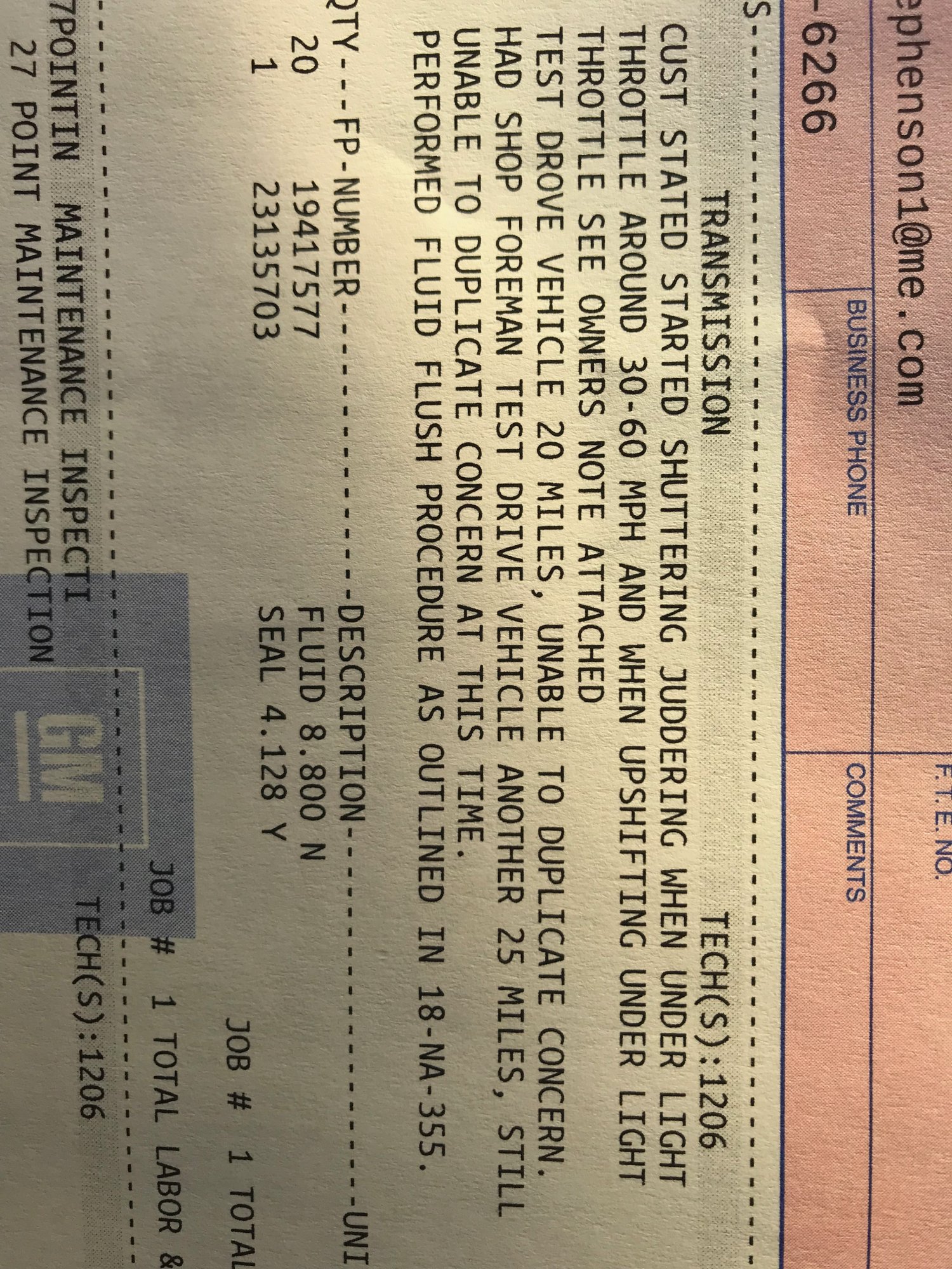

FYI,  went to local dealership and explained to the service manager this issue and he immediately confirmed that the fix is flushing the transmission fluid and replacing it with a different type of fluid (not sure about all the specs).  Am having this done Monday morning and will report the results some time next week.  BTW, also getting nitto ridge  grapplers 305/55r20 installed, truck has rough country 2 inch level up front.

I may be duplicating my post - but, I can't find the post I saved so will do this again ...
They flushed and swapped fluids per the procedure shown on the attached photo ...
On 10 mile drive home seemed like a normal transmission ... no shuddering, no jerking ... didn't even clunk at intersections while slowing for the light.
Will see ...

Put about 240 miles on the new fluid today .... noticeably less clunk upshifting from 1-2 under light throttle, and downshifting while easing up to traffic lights.
Rock solid rpm while cruising at 1200-1500 rpm ... no waver, no rumble strip feel and no weirdness as it upshifted with light throttle at higher speeds ... smooth downshifts while slowing from higher speeds.
Need more time, but seems much, much improved.
