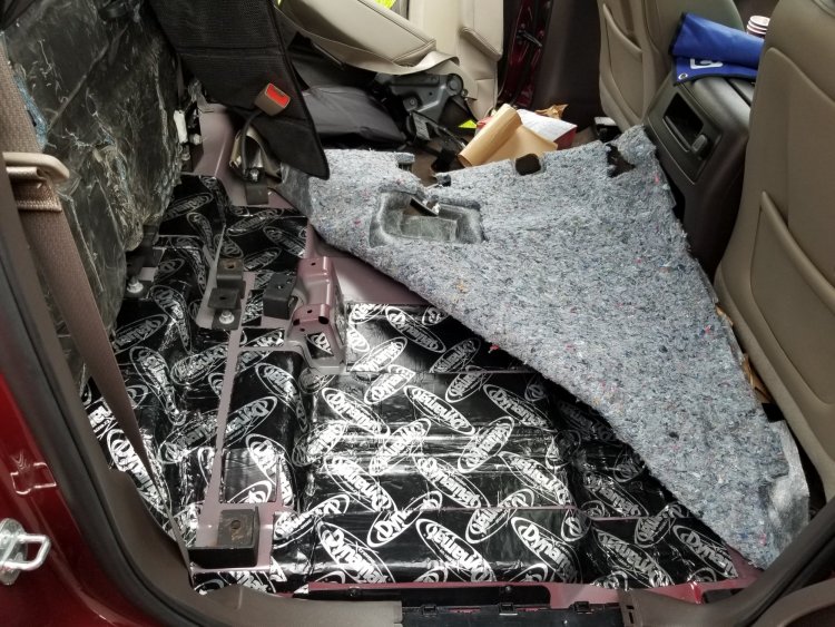

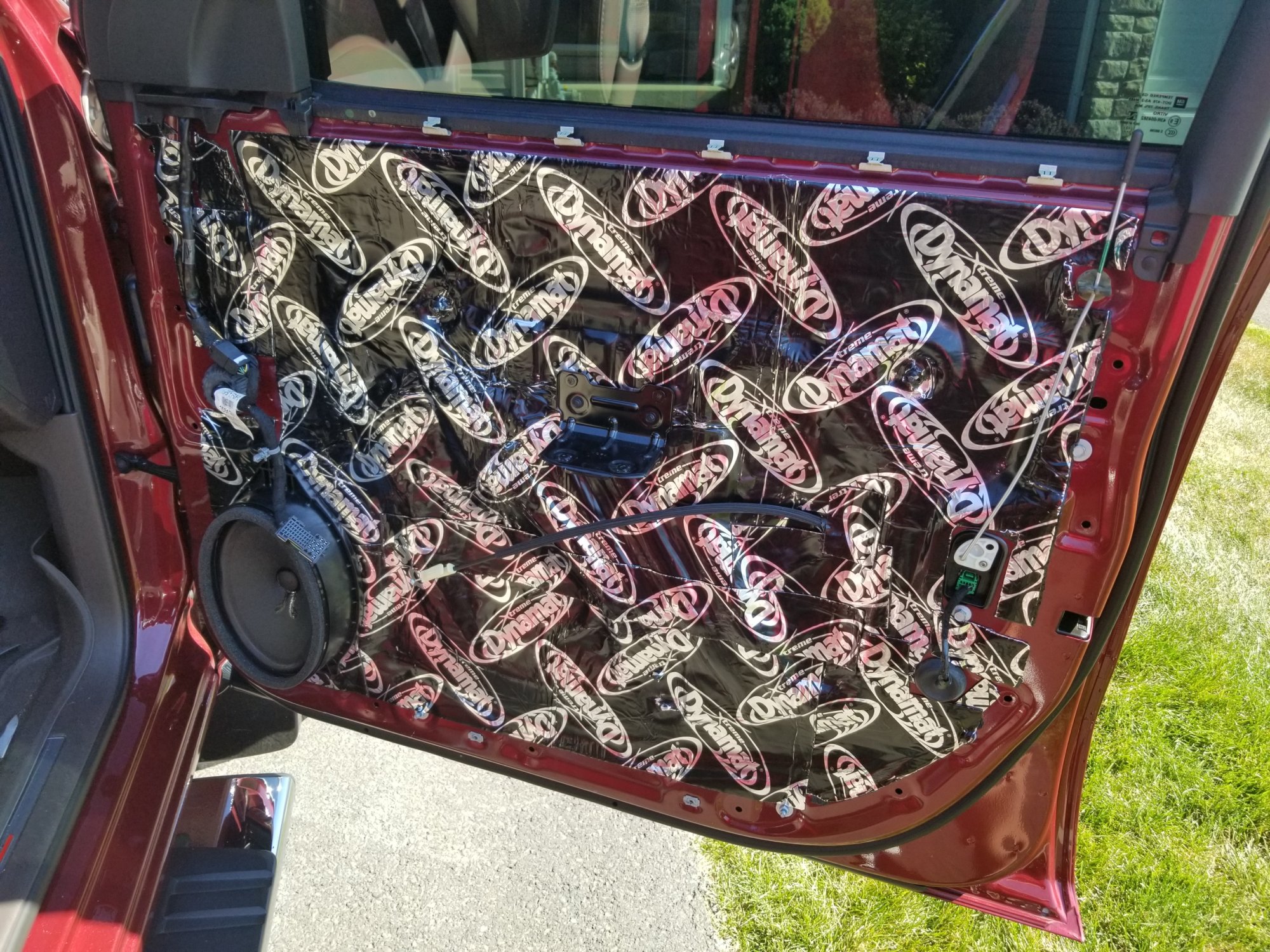

Along with having the entire truck covered with Dynamat, its sealed so tight that when I put the hvac on, your ears pop. The doors have 100% coverage on the outer shell and the inside shell. Floor, firewall, and roof completely covered. Its stupid quiet when the radio is off. Almost weird feeling. Even with the Borla ATAK exhaust.

Forgot to say that the only reason i didnt put the tweets where you did was because i felt like there was to much seperation between the mids. This pic was before i installed the woofers.
So are your tweeters, mids, fd woofers running off one source signal (L or R) and "crossed over/tuned" 3x, or do the dash mids run the center channel mono source? What JL processor hub do you use?
Sent from my SM-G960U using Tapatalk
The nav-tv unit takes the full range signal from the radio and sends it to the jl vxi hub. I think when you use the nav-tv unit, i think you loose fader. Then the hub distributes the full range signal to the amps. Then the amp inputs are programmed to each speaker position. So then you set crossover points, gain, and time for the specific speaker you assign to it. So, you really could have a woofer where the tweeter is. Its all settings. The amp does all the work.  Its like having a 30 band eq for each channel of the amp.
Im using all 8 channels.
2 front tweeters
2 front midranges
2 front woofers
2 rear door focal yellow components running passive
The 600/1 is running a shallow mount 12" jl sub.
Its all tuned via laptop and done wirelessly too. Check out the jl app. Called TUN.  Pronounced tune. They have a simulator to play with. It took a couple hours to set up all the speakers and hook up the rta to make sure there are no dead spots.
