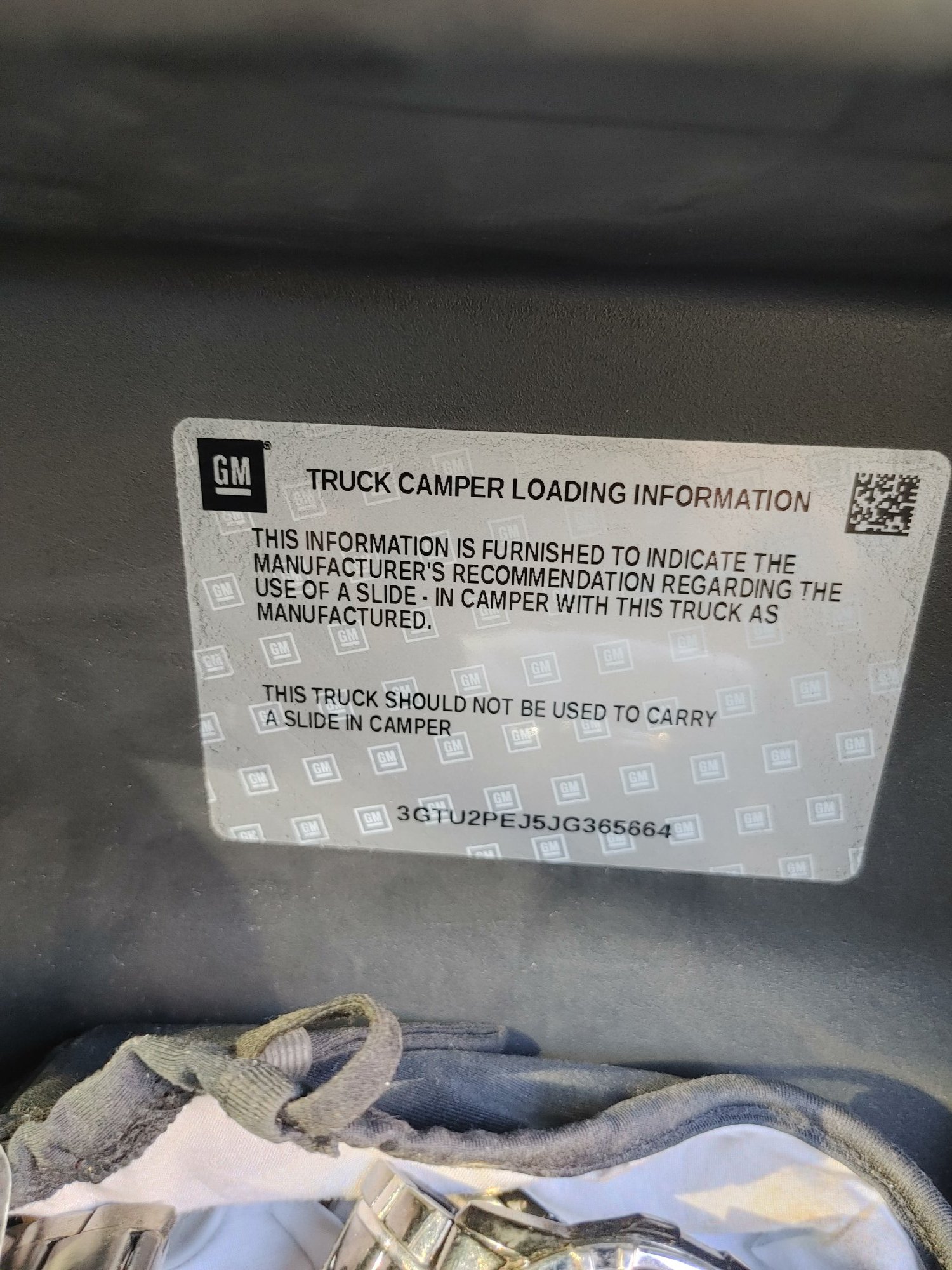

6 hours ago, gljarrell said:
I have a 2018 Denali I do not see that sticker in my glove box
Welcome to the site.
No RPO sicker in the glove box on 18's. You have a QR label in your drivers side front door jamb. Use the QR reader on your phone and most of the RPO codes will pop up.
